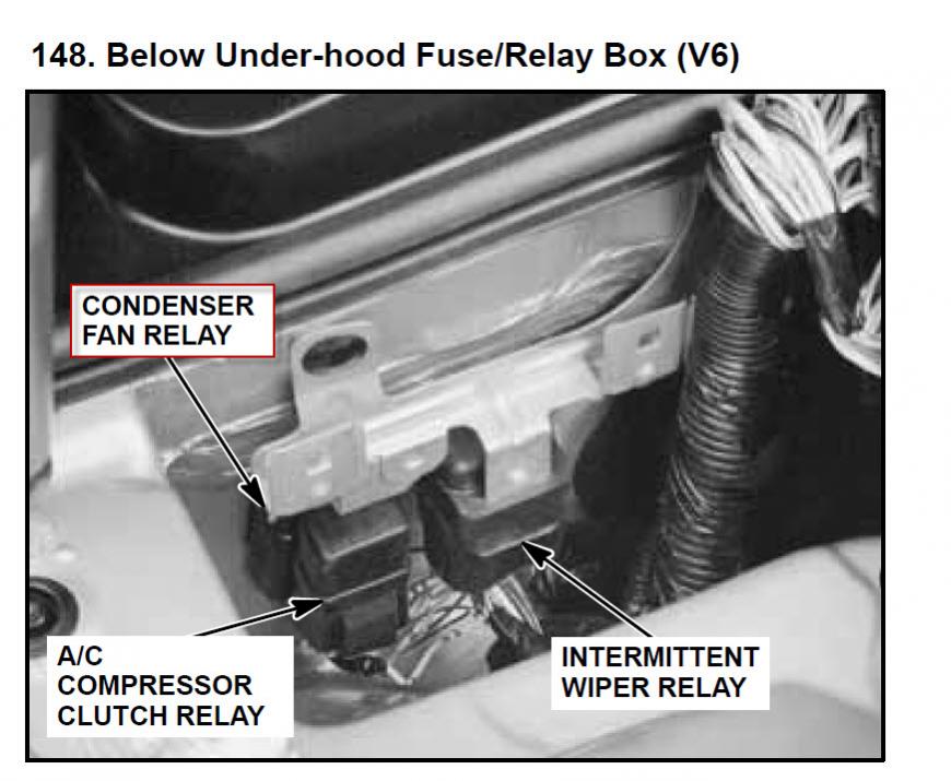

2. Now, we move on to do a couple of tests to try to narrow down why the condenser fan may not be running.
If you have a multimeter, here are a couple of tests. There are other tests that can also be done
Locate the A/C condenser fan relay (see attached photo). Unplug the harness connector. It will have 4 terminal cavities.
Test for voltage: At the A/C condenser fan relay harness side terminal cavity with the Yel/White wire (Yellow with a white stripe), test whether there is voltage (+) with the ignition switch ON. (Make sure you replace under-dash Fuse No. 8 before this test.) Multimeter's red lead to the harness terminal with the Yel/Wht wire; and meter's black lead to body ground. There should be voltage (+). -- Report your finding.
Test for continuity: For this next test, you can turn the ignition switch off.
First jump the fan switch with a wire or paper clip and leave it in.
At A/C condenser fan relay harness side terminal cavity with the Grn wire, test for continuity to body ground. There should be continuity.
To test for continuity, set the multimeter to either the "ohms" or the setting it will beep when you hold the two leads together.
  • If your meter beeps, it means you have continuity.
  • If it is on ohms scale, you will have continuity when it reads close to 0 ohms.
  • If it doesn't beep , shows OL (open line) or a 1 (infinity ohms); it means you don't have continuity.
