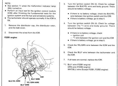

The BLK/YEL wire into the the coil/ICM - Can you hook up a test light to it and watch it when/as the car dies out?
cleaned the battery terminals it cleared the vtech solenoid code but the car still acts the same I poked the black wire with the yellow stripe coming from inside the distributor but the light bulb never did anything? the car actually killed itself out after I gave it a 2000 rpm rev it died out and I had to crank it back up but no codes are saved in the ecu.

You prob alreay have this but just in case.
