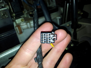

Today, I was messing around under the glove box trying to fix it and a wire sparked - then the dash light wouldn't come on at all. The wire that sparked comes from an 8 wire plug under the glove box that had several wires cut (must have been before I owned it). Does anyone know where this wire is supposed to connect? There are no adapters visible, but I have heard of a cruise control module or actuator that can usually be the culprit... Please let me know if you have any thoughts!

What color is the 8-P connector plug? Is it black? There is a black 8-P connector plug for the radiator fan control module located behind the glove box.

Here's some pics...
Attached Thumbnails 1995 Honda Accord Cruise control problem-20130204184207.jpg

That's the connector plug for the radiator fan control module.

Is that on the same fuse as the cruise control? I'm wondering why a spark there would cause cruise to go out. I had an aftermarket fan control unit put in since it was not working.
Old Feb 4, 2013 | 07:21 PM
The common fuse is the No. 4 (7.5A) located in the under-dash fuse/relay box. The cooling fan circuit and cruise control circuit have other different respective fuses protecting their circuits; however, the No. 4 is the common one.
You may also have to re-check various fuses in the under-hood fuse box and under-dash fuse box. The aftermarket fan control wires may be spliced into some other wiring other than at the radiator fan control module connector wiring; or caused a short in some other wiring circuit.
