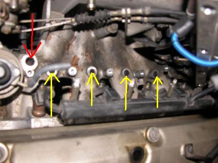

Old Mar 29, 2013 | 06:47 PM
OP- the egr "ports" on these need to be cleaned every now and then.
There are several write ups on "how to" do this...the fuel rail has to come off. I suggest new o-rings for the top of the injectors but that is me.
Here are mine when I did this a while back.....three of the four to the intake were done...two were totally blocked, the third was just hanging in.
The red arrow is the "port" from the valve...you are there, clean it. The yellow are the ones to the intake runners.
