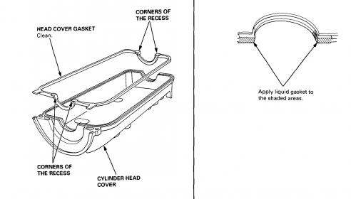

You can pick up a complete Fel-Pro valve cover gasket set for ~$20 at most parts stores. I used that brand on my car and had no problems with the quality. The set will include seal between the cover and the head, the VC bolt grommets, and the upper tube seals. Get some Permatex RTV Grey, because you will need some for the base of the two archs (see pic below).
Attached Thumbnails 1996 Accord 4 cyl, crank but won't fire...any ideas?-untitled.jpg
