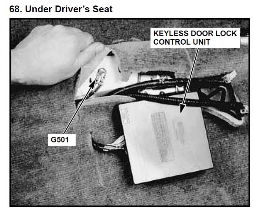

1. Look under the driver's seat, do you have the same factory keyless door lock control unit as in the first picture? That is usually on the wagon with the factory keyless controls. That unit control the door locks. If you don't have it under the seat, then the door lock unit is in the driver's door and consider without the keyless locks.

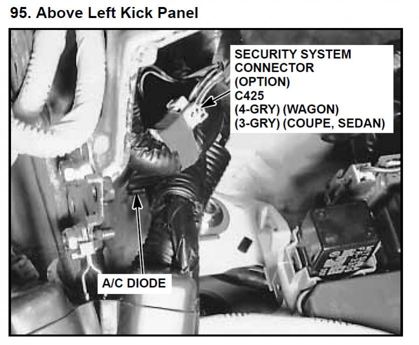

2. If there is an aftermarket or Honda accessory security system, the system is usually plugged into or connected to the wires at shown in the second picture of the optional security connector (those wire are the lock and unlock wires to use for the security system). -- For aftermarket systems, you may see the unit under the dash too.

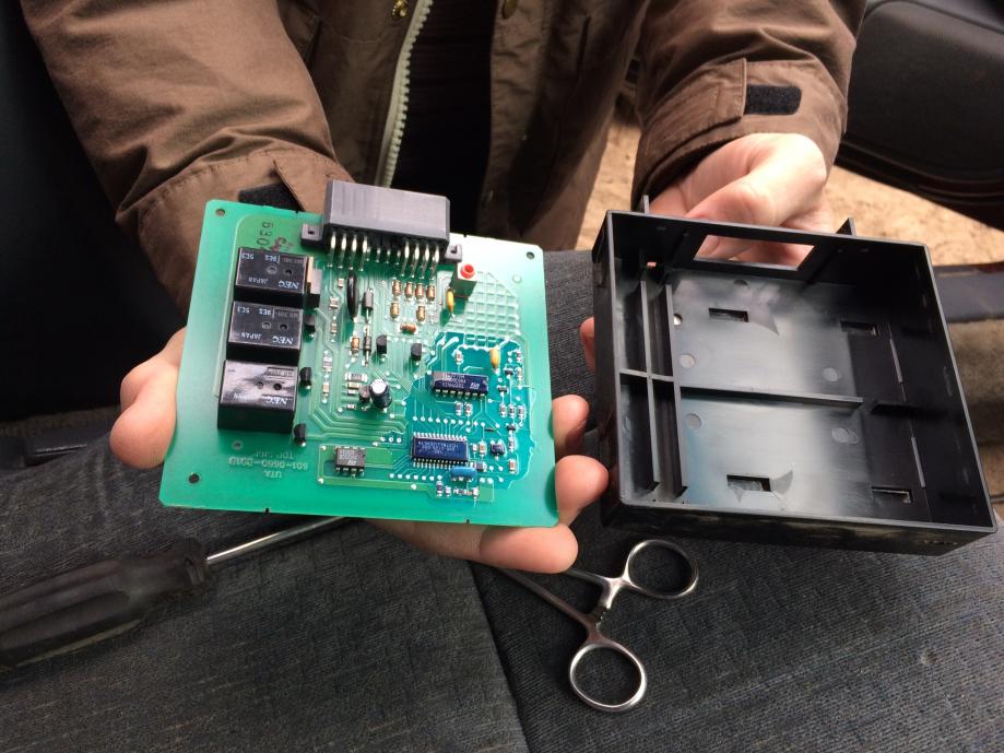

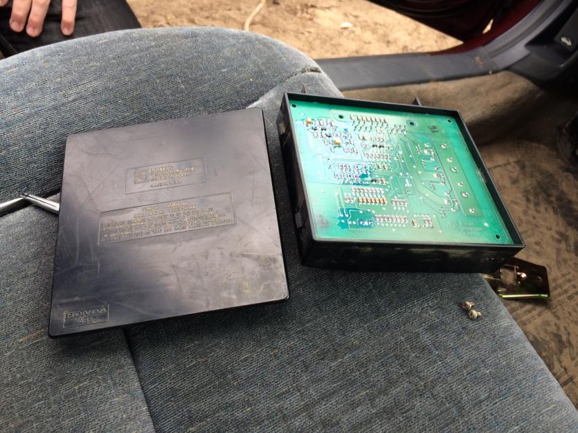

If you don't have an add-on security system, the issue may be due to the keyless door lock control unit located under the seat.
Examine, the wires and connectors terminals to that unit. If wires and connectors seems okay, then you may want to remove and open up the control unit to visually examine the circuit board and internal components.

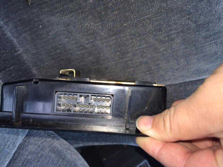

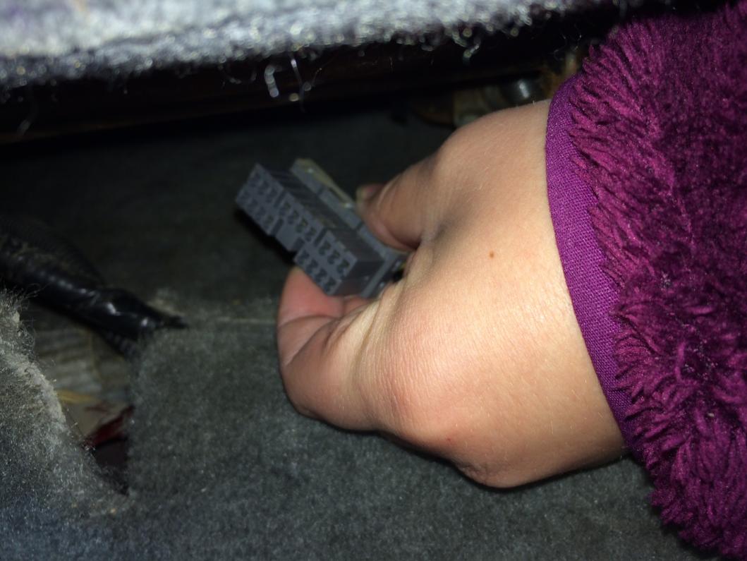

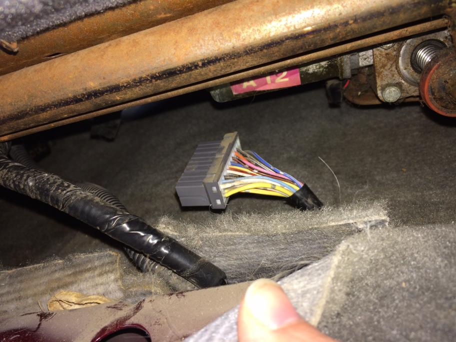

Ok, I was able to take a better look at this today. I have the factory keyless door lock unit under my driver's seat.
I detached the connector and the locks stopped acting up (cycling when no button was pressed, ect...). I can still lock and unlock the two front doors manual with the key, but now the I can't lock the other doors via the driver's side key. It just locks that door now. (Side note, I still am unable to lock/unlock the rear hatch with the key so that may be something different, hmm).
I have included photos of my unit, the connectors, and the board. I don't see anything wrong right off the bat. What should I be checking for?

Here's more attached photos.
Attached Thumbnails 1996 Power Door Lock Mystery-img_5731.jpg   1996 Power Door Lock Mystery-img_5730.jpg
