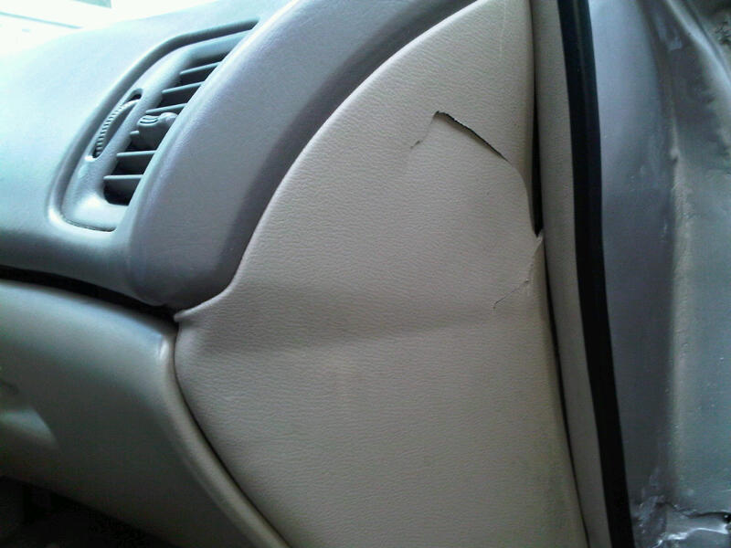

I have attached a pic of a cracked side-dash(?). Don't really know what it's called. Friend of mine cracked it accidentally. Now when I drive (windy or not), it's really noisy in the car. The wind comes in from there.

The part is an instrument cover, Honda part number 77215-SV4-A01ZJ. Honda list price $28.17, internet Honda dealer around $20.62 plus shipping.
Or go search for one in a salvage yard.
