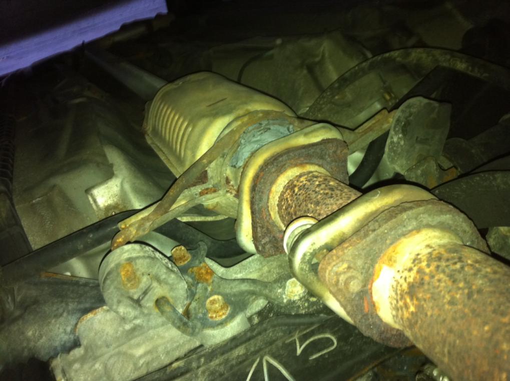

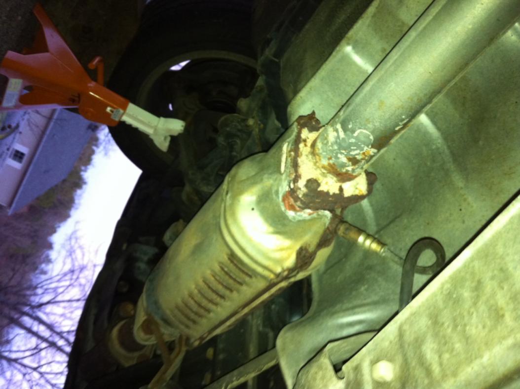

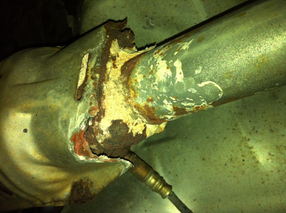

Here are some pics of what my set up looks like. The cat has some JB Weld on it to close up a few exhaust holes.
If anyone has any advice on how to get that second O2 sensor I'd appreciate it. I don't even know what tool to use to get that freakin thing off. lol

A couple of months ago I replaced my cat with a Walker Direct Fit 16067 due to a P0420 CEL. $100 shipped free from Amazon with a $40 rebate. I don't know if the rebate is still valid. I had to cut the back bolts off with a torch and I had to heat the O2 sensor with a torch to get it off. The threads on the sensor didn't look too good but it screwed in OK, doesn't leak, and no more CEL. The cat itself fit fine on the stock hangers.
From the pics, it looks like your rear pipe flange is rusted away, not the cat, but maybe I'm not seeing it.

Yea with the rust and "stuff" on the rear, you might want to replace that pipe along with the cat.....I'd unplug the O2 and drop it with the pipe. Once on the ground you can decide to re-use the old O2 or replace it.
