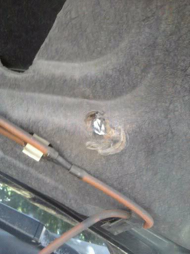

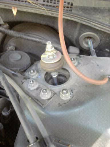

Hello everyone, new guy here. I just installed new (sensen) struts on my 98 accord(4dr ex, 4cyl) and I ran into a problem a day after the install. I noticed alot of rattling whenever I hit the smallest bumps. I then noticed the hood moving at the same time. After creeping home I noticed the strut had pushed up and almost went through the hood. Has anyone had this issue off hand know what caused this? Obviously I did something wrong during the install. The right side seems fine but I havent been able to get in there and check things out. Im going to try to attach a pic of the problem. Thanks in advance for any help. Im really stuck right now.

wow - you def have that wrong
Another member will come and post a diagram of how they were supposed to be installed
Do not drive the car until fixed

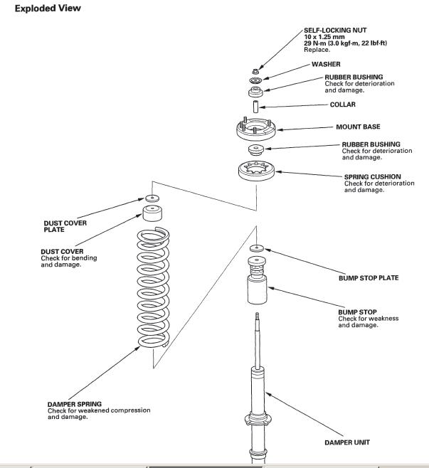

Old May 30, 2012 | 08:18 PM
Yea, that is going to have to come back off....then figure out what went wrong. Could be the strut mount (base) gave out?
