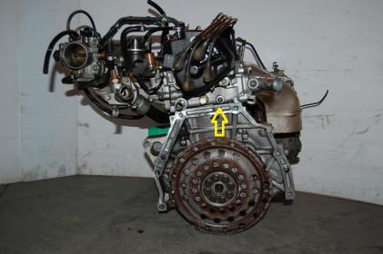

If you unplugged the sensor I labeled with the yellow arrow, then there is either a problem with the wire from that sensor to the instrument cluster or you had two clusters with the same problem?
I would reinstall the old cluster, because the lights work on it. When you unplug the old cluster, you will want to test that the wire in question has an open circuit to ground when it is unplugged at the sensor on the engine.

Thanks for the pix, after I unplug the wire, it doesn't move at all from C. Once the wired is plugged it, it slowly rises to H after idle for 10 seconds.

Then you need to replace that sensor. It is called something like the coolant temperature sending unit.
