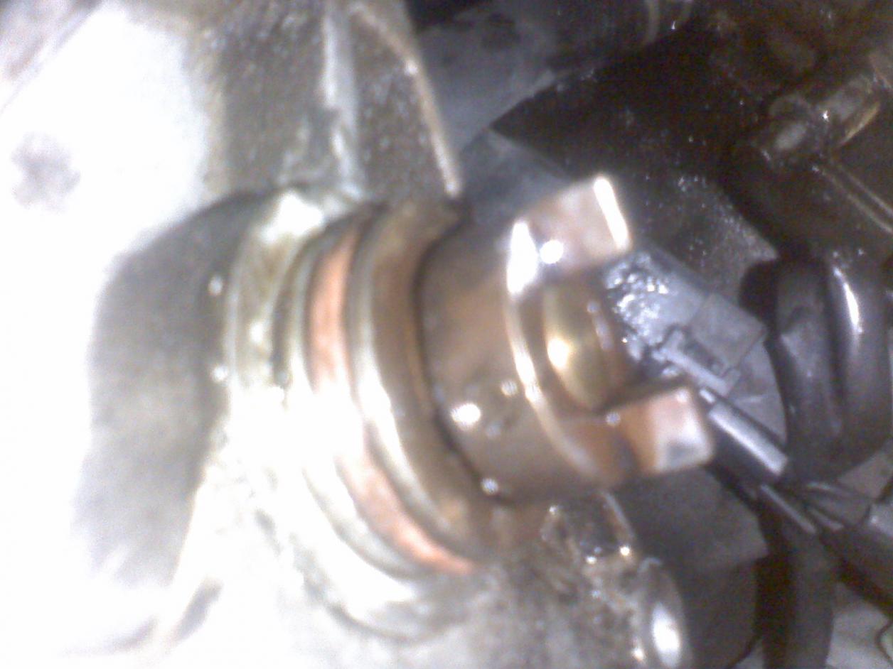

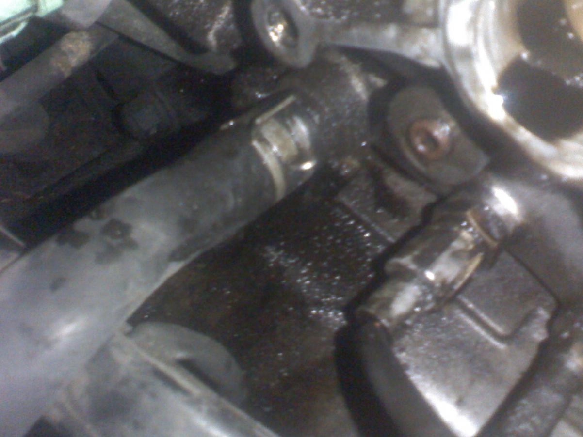

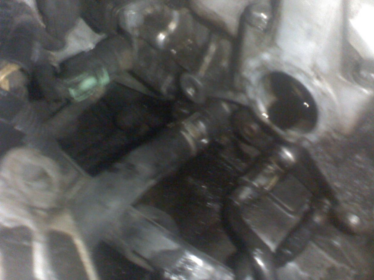

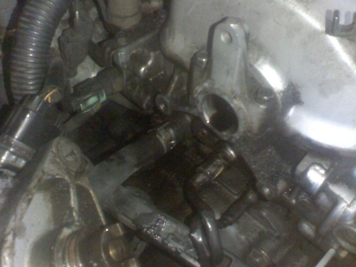

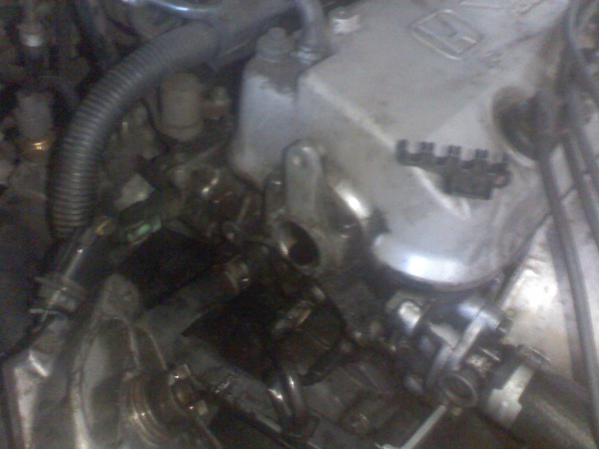

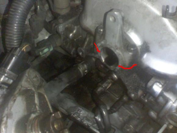

Hello,
I have some oil leakage when I accelerate fast, if I don't punch it everything is fine. I read this thread
https://www.hondaaccordforum.com/for...passenger+side
and changed the o-ring.
I am still having the oil leakage. here are some pictures. What else should I check?

I've been working with deserthonda to figure out what the matter is.
I still have a leak and I have replaced the O-ring and Valve cover gasket.

it looks as if leaking from the distr o-ring,, rt side valve cover gasket?? .i would replace the distr o-ring first , it is cheaper about 3 dollars from dealer,, before you remove the distr get a magic marker and scribe a line on it and the where it mounts, so u can reposition it on the same place
Thanks for you help.
I have changed the o-ring. It still leaks. I've gone to buy the valve gasket and will put it on today. Any other idea what it might be?

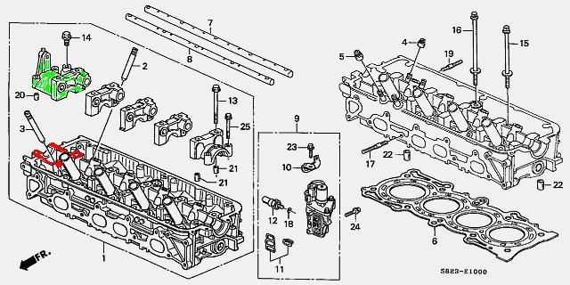

What about leaking from underneath the camshaft bearing cap?
In the picture, the bearing caps don't have part #s, but look at the distributor end, near labels #14 & 20. That bearing cap extends out of the VC gasket. Sealant is supposed to be used between that cap & the head.
Clean it up & watch to see exactly where it leaks. This leak I mentioned will come out of a horizontal split line just centered on the distributor opening. Your photos sorta look like it's dirty below that line, & cleaner above it.
If you decide to re-seal that bearing cap, find a manual & look up the bolt torque. Don't pull the threads out of the head casting... Actually, if you have to do that, I think you'll need to dismantle at least part of the valve gear.

Could you circle the area you are talking about, in my pics or your diagram, please. I just want to make sure I know what area you're talking about.
I made the last bearing cap green. The red is where it bolts down to the head. That red surface should have sealant when you assemble. If not, oil can leak out from the horizontal split line between those 2 parts, where I highlighted your photo.
Remember, I'm just speculating one possible place for the leakage. You have to clean up the engine & verify it's really leaking from there. It's a big-ish job to remove the valve gear & last bearing cap, so you don't want to disturb that stuff until you know that's where its leaking.
