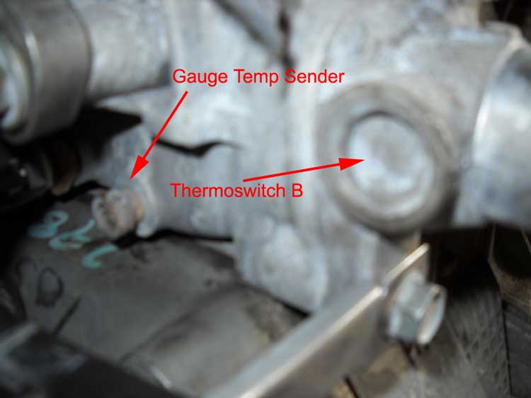

Problem: Coolant temp gauge does not work due to the fact that the new engine uses 1 sensor instead of 2.
Is there any way to get the gauge to work?

Take the plug out of the cylinder head and put the gauge temp sender from your old engine in.

Thanks. Questions:
1. Do I need to drain any coolant before removing the plug?
2. Would this not being connected affect how the engine runs or is this function controlled by the other sensor that connects back to the ECT/PCM?
3. I know there is another unit that controls the fans, but does this unit also have control over the fans? The reason I ask is because the fans seem to only come on whe I turn on the air conditioner.

  1. You'll lose some coolant. Best to replace it when the engine is stone cold. The sender is high up on the cylinder head so draining the radiator will reduce coolant loss to a minimum.
  2. It's just for the gauge. Another sensor, the ECT, tells the computer how hot the engine is.
  3. Nothing to do with your fans either. You don't list your location, but @ 70°F the fans rarely turn on unless the car's been idling for 20 minutes to a half an hour.
