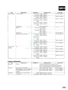

I just found it in the 1998-2002 Helm book.
At any rate, if you have the car warmed up or not, even if you let it sit and drain for a week, you aren't going to get close to the rebuild capacity.
Always go by the dipstick level when you're finished with whatever job you're doing.

Wow, good stuff. I've never seen an engine which held 1.4 quarts out of the oil pan. Yeesh, where does that engine keep it all?
Old Mar 19, 2018 | 03:11 PM
I don't know - haven't rebuilt THAT engine.
You can see a lot of puddles of oil below the camshaft when you take off the valve cover, but that seems like maybe only 250 cc. Judging by the parts drawings, I bet there's quite a bit that doesn't drain out of the oil pump.
Agreed, but I'm thinking even the largest positive displacement oil pump I've ever seen might hold maybe 100ccs, max; that leaves a whole lot of oil unaccounted for.
