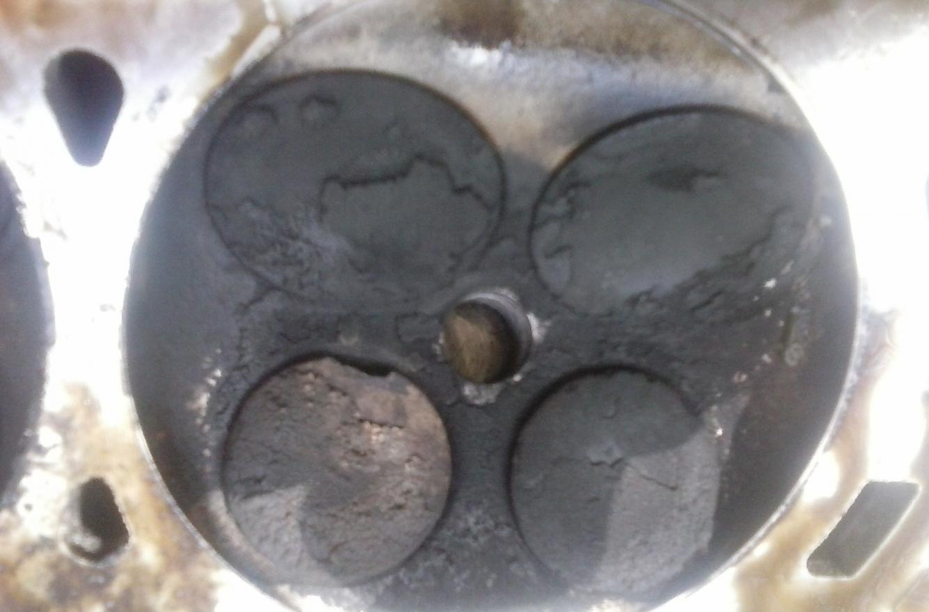

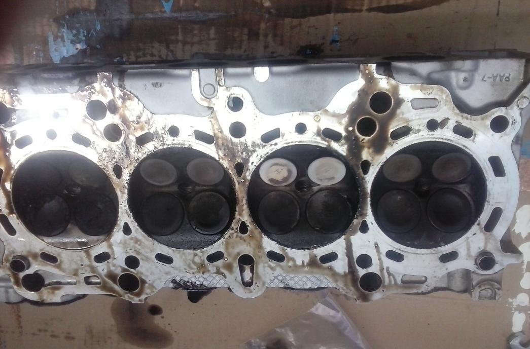

Hi all. Thank you for the tips. Question: if there is a loose wrist pin, would the piston hit the valve causing it to crack? Regarding the valve gaps, I didn't check anything on the head. I'm hoping these heads are rebuilt and have all the camshaft stuff checked by someone qualified. Attached are a couple pics.

I doubt a loose wrist pin is the fault, however I don't know tolerances between pistons and valves, so can't comment on whether contact would be possible.

Agreed, with that crack it is highly unlikely to be a wrist pin (or any other form of contact between the valve and the piston), then again, is the piston marked in any way?
I'm inclined to go with a flaw of some sort in the rebuild, however, that doesn't explain why you've had two consecutive heads with a similar (identical?) issue.
The looks of the valve do not indicate a burned valve (at least to my eyes), so I'm thinking probably not a mixture issue or a misadjusted valve.

Update. I did not see anything obvious on the piston. I am relieved no one else thinks it is the wrist pin. There is no way I can work on the bottom half.
