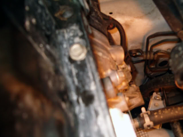

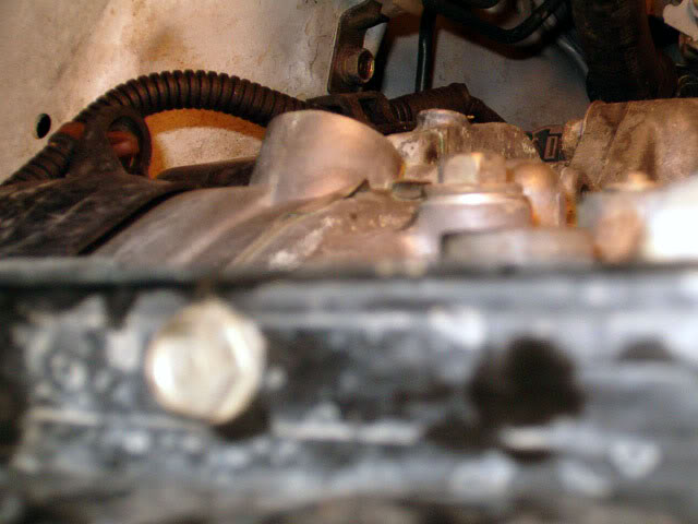

Here are a couple of pictures. I'm not sure you can see very much though. It's on the driver's side on the back of the engine.

Your second picture if what I am looking at is the coolant trail looks like it starts high up and is in the cylinder head area. Can you get a mirror and see where it starts.
