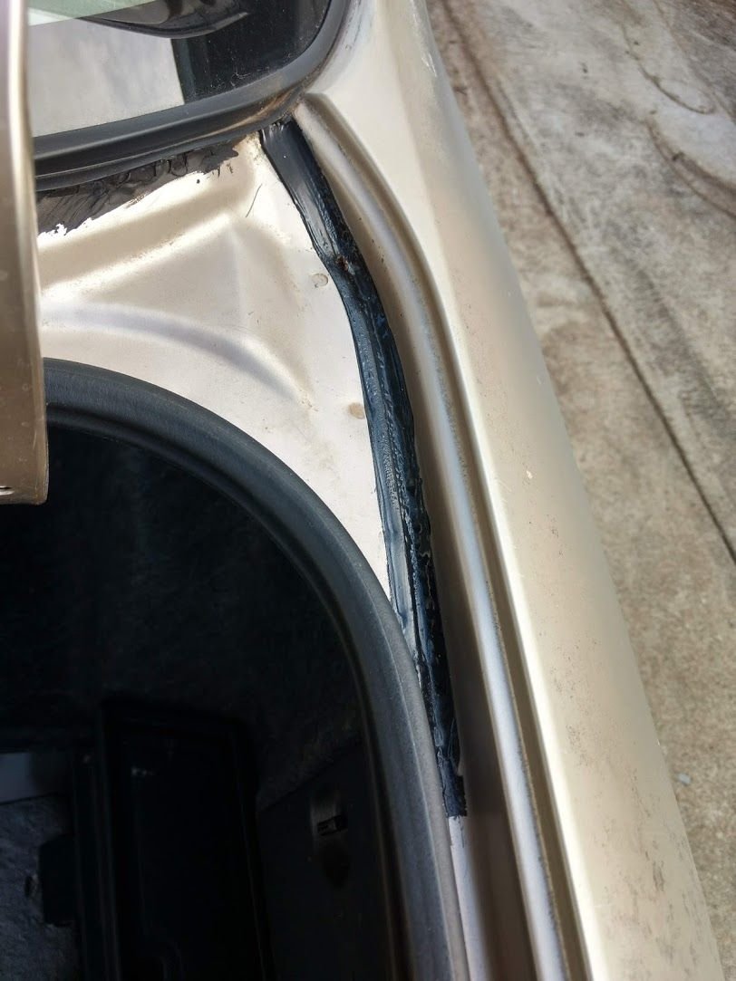

I had water leak in the trunk over time and didnt know it. After watching this video
, I chipped away the old dried seam sealer and re sealed the seams on both sides with POR Patch and thought I had it. But its back again.

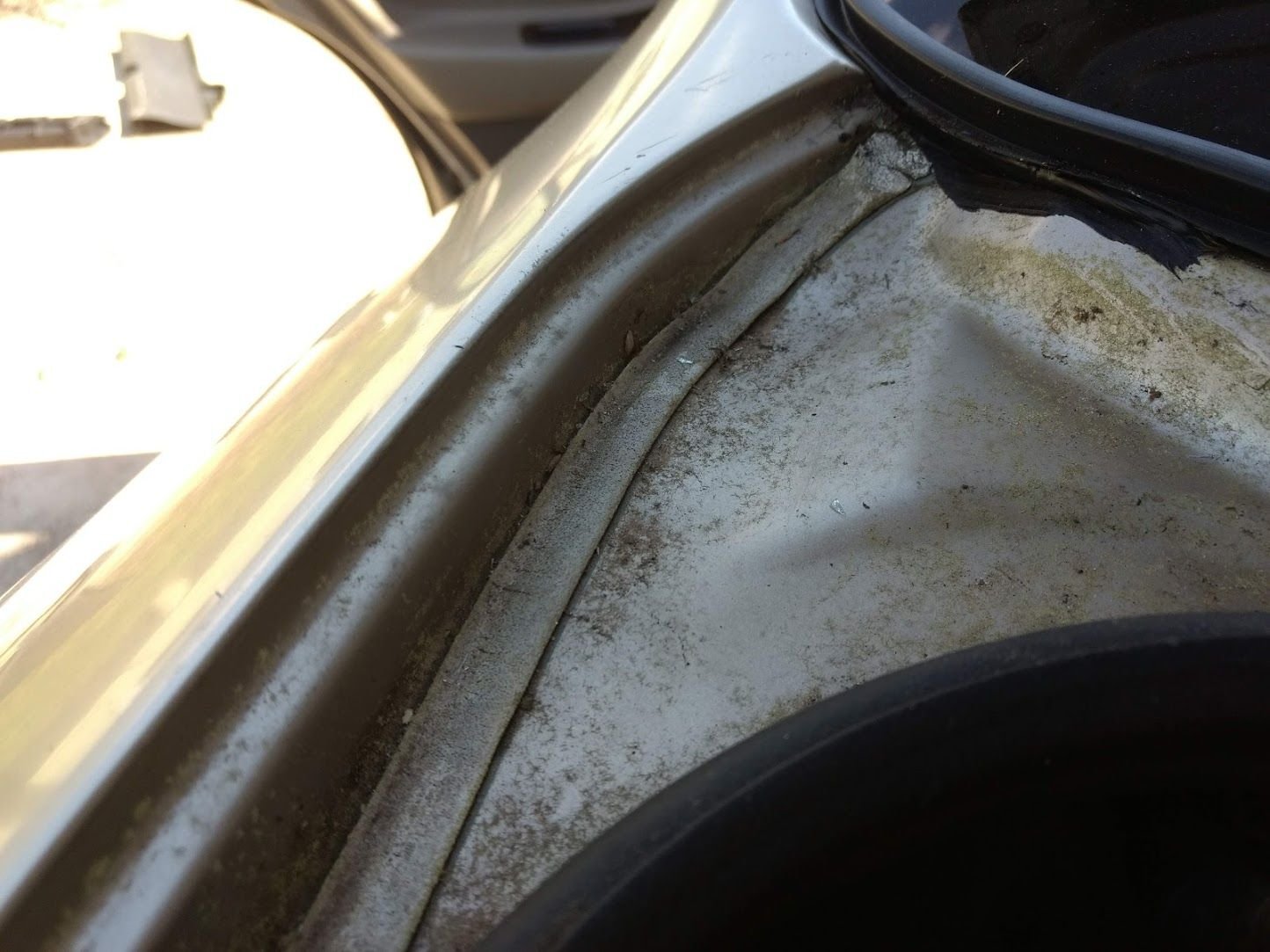

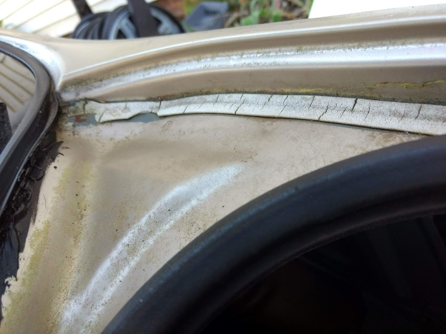

This is what the seams looked like before I chipped it all off and re sealed.
and the re seal job

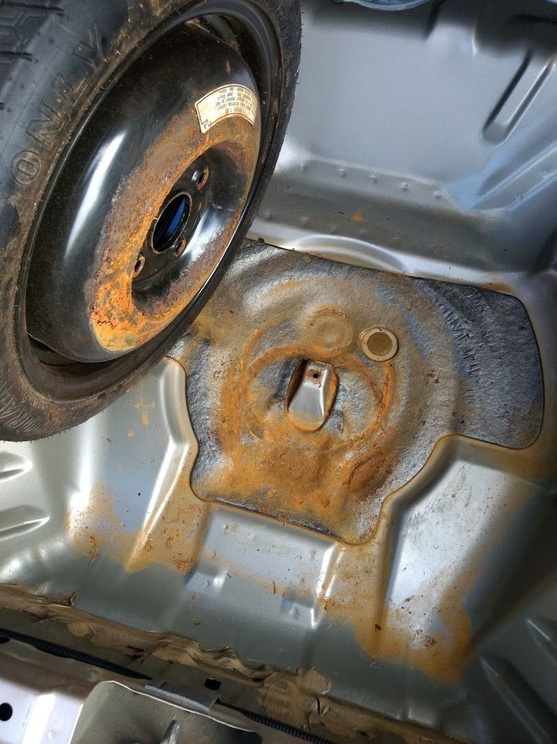

Sprinkle baby powder around the suspicious places - any water leaking in will make tracks in the powder.

Did the sprinkle of baby powder in the trunk last weekend
Old Aug 18, 2021 | 04:53 PM
msg's Avatar
msg
Joined: Feb 2019
Posts: 48
Then we had the tropical storm Fred come through Monday and Tuesday. I popped the trunk today and saw this.
Its definitely the right side where the leak is coming from, and no surprise since it was that side the lady backed into the rear left fender and door. But I had done the seam sealer, so I wonder where its coming in at?
