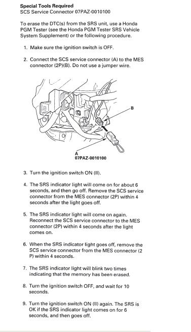

Yes, there is a re-set for the SRS. As for the windows working/not working we can get into that after.

Old May 18, 2017 | 06:07 PM
For the SRS, here is the procedure from the service manual. I'm sure there are vidros on the internet as well.
Attached Thumbnails 2000 Accord-SRS and Malfunction Lamp On-6th-gen-srs-reset.jpg

Thanks, this procedure worked on my first try. Most appreciated.
