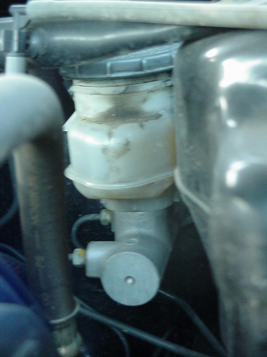

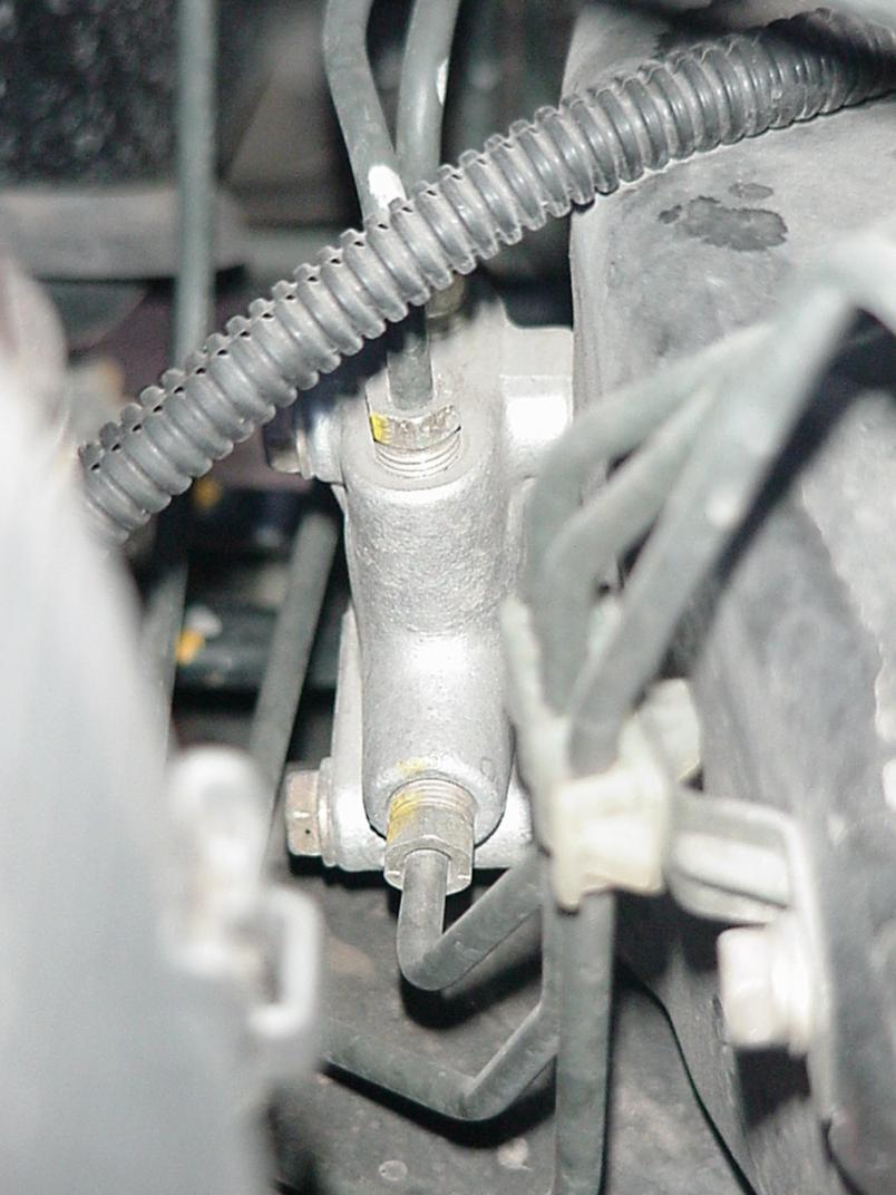

So I tried to just put the car in the ON position. The radiator fan came on pretty loudly, but was unable to hear the ABS pump turning on. I was trying to feel the ABS pump for some kind of vibration, but there was nothing. So, by following the lines from the brake fluid reservoir, it goes directly into the ABS pump, and then (I think) it distributes it to the calipers in each wheel. I didn't follow it that far. Just looking at the lines within the engine compartment. I'll try to provide some pictures later. Perhaps it will give more clues as to what I need to fix/replace. I was able to find some modulators on ebay for a pretty decent price, if I really need to swap it out. It ranges from $50 to over $100. Of course, there is no returns on these items. I just want to determine what is wrong first prior to changing parts. Thanks everyone for your inputs.

So here are the pictures. So from the reservoir, it goes to the ABS pump, and then it goes to what looks like a distribution block. From there, I'm assuming that it goes to each calipers. I have not checked where each lines actually goes, yet. Probably will do that this weekend if I have the time.

Just for educational value, your 3rd picture ("distribution block") is the proportioning valve.
