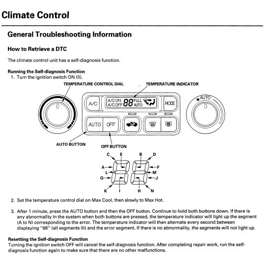

I attached a procedure to check for HVAC codes on the climate control. Let us know what code you get.

I ran the diagnostic and it gave me an N

Yes, my daughters car is a V-6. I ran the diagnostic that you sent me and it gave me an N.

A code N refers to a problem in the blower motor circuit.
