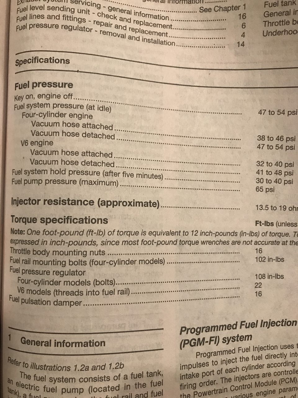

TPS wires RED/BLACK.
MAP wires RED/GREEN.
*Bad news, I replaced my TPS sensor and it did not fix the problem. I crank, engine starts perfectly, when it's cold IDLEs just fine. When it warms up and RPM drops to the 0.5 mark, if I press down on gas pedal, car shuts off. I re-rented the Fuel Pressure kit from Auto Zone, and looks like we have low fuel pressure again. It's at 20 Psi, which is far below the minimum required of 36 to 48 Psi (Haynes Book). I'm going to recheck the Fuel Pump as "The Toecutter" mentioned up above. I bought the cheap Fuel Pump $50 bucks or so as opposed to the $120 something (Bosch) one from Autozone. Not sure if the pump is bad, or debris are caught in line. Either way after all the sensor replacements I've done so far, looks like issue is pointing back to a fuel problem again. GRRRR

Did you clean out the fuel tank when you did the replacement? Did you replace the sock filter? Debris in the fuel tank can destroy a fuel pump quickly.
If you unplug the vacuum line to the fuel pressure regulator, does the fuel pressure increase to normal?
It is possible that you are not getting the full 12V to the fuel pump when the wiring is plugged in. You would have to back-probe the connector on the power wire to see if the fuel pump is getting 12V. Testing for voltage at the connector with it unplugged can mislead you to thinking you have 12V when the wiring has current running through it.

I'm definitely keeping my fingers crossed on this one. I replaced/exchanged the original Auto Zone Fuel Pump (10 days since purchased from AutoZone) with another today. Problem has been resolved, and car no longer shuts off when I press on the gas pedal. Although, I am noticing some very weak and random hesitations. Definitely not like before where it wants to shut off. And the warmer the engine gets, the less it happens.

I didn't test disconnecting the vaccum line to FPR. I will test this on the new pump now, as I'm having very very minor hesitation at colder temp. With the new pump, car no longer shuts off and performance is SO MUCH better.
