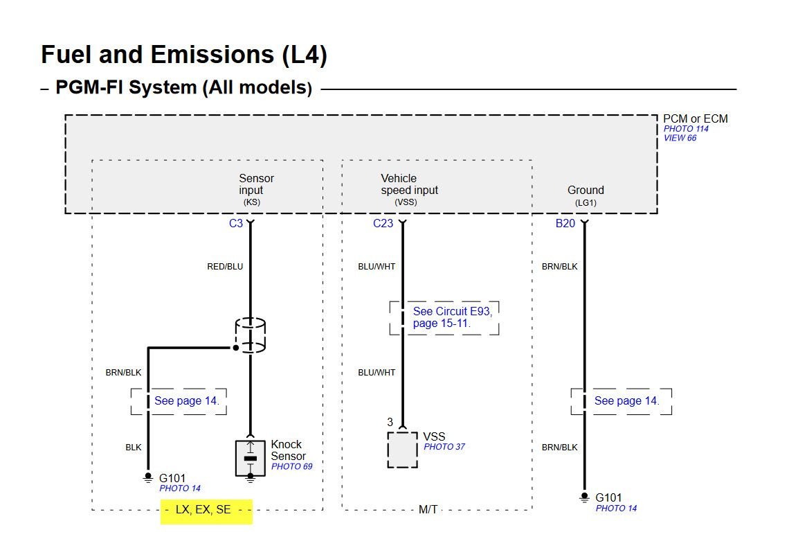

Only LX, EX, and SE trims have a knock sensor.

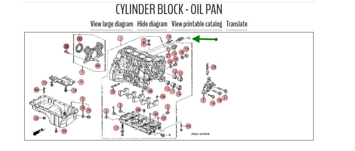

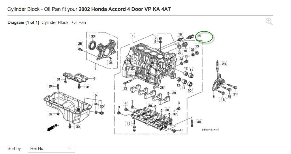

If a search is done with the car's specs. first (e.g., year, trim level, etc.) at reputable online Honda dealers, the knock sensor would be blanked out in the applicable detail listings.
For example, the knock sensor is # 14 in the parts image diagram; but, there is no # 14 include with the applicable detail listing under the VP at the same page.
Example #1 at Honda e-store (official Honda site):
See link:
https://estore.honda.com/honda/parts...n=&b=E++14&dl=
Example #2 at Honda Parts Now:
See link: https://www.hondapartsnow.com/parts-...k_oil_pan.html

Default I'm satisfied, no knock sensor Installed.
See link:
This Accord VP never had a knock sensor Installed. So I'm ending this quest. Thanks for all the info and help.
