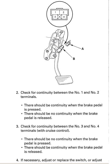

When you installed the brake switch, did you verify that pins 3 & 4 have continuity when the pedal is not being pressed. The switch can be tricky.....not quite right and yes the brake lights work fine but the cruise will not...its like two switches together....if that make sense.

As to what occurred with our cruise control, we had noticed the cruise had stopped working. Did a little research and determined the culprit was the steering wheel switch. It simply would not click and turn on the cruise at all. Replaced that and all was good. Months down the road, we noticed the car had no brake lights. Did a little research and found the issue was the brake light switch. Replaced that and thought all was good for we now had brake lights. The next day, my wife was telling me that her cruise control would not work. So this leads me up to where we are now, trying to trouble shoot the cruise control without a manual of any sort but with internet resources and of course your help to this point. It is much appreciated. I will try your suggestion about the brake light switch. It seems when we initially installed the switch, it would not come on till we adjusted the threads one way or the other. Will post again after I get an opportunity to do the tests. Thanks so much. Post anything else you may find to be helpful with this issue. Again, thanks. Oh and thank you for serving our country.

Sounds like the switch isn't adjusted properly....based upon the story. Again it can be tricky. The switch needs to be fully closed...plunger pushed all the way in....so it sounds like you need to "screw it into" a tad more.
