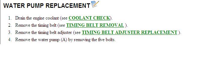

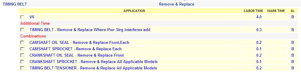

According to Mitchel, you are looking at 5.4 hours of labor, that includes the cam and crank seals and tensioner. Now there is not an option for adding the water pump replacement to this but if you look at the preocedure, you have to do the 5.4 hours of work and then remove 5 bolts and then re-install those same five bolts.....So IMHO, that is at best .2~.3 hours of additional labor....so 5.7 in labor.
The rest is the cost of the parts.

That's extremely helpful poorman. I appreciate it - those labor estimates will come in handy when i have this job done. Now if only I didn't live in NYC and have to pay 110/hour for labor.
