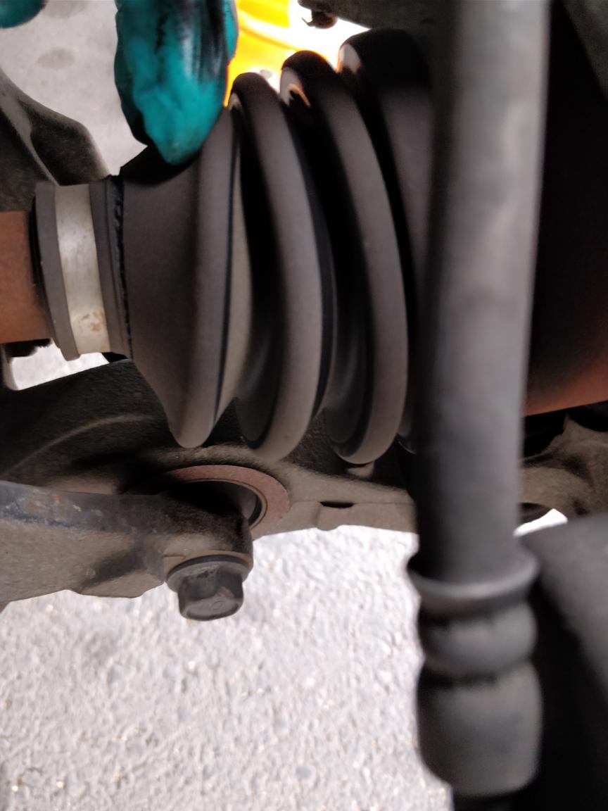

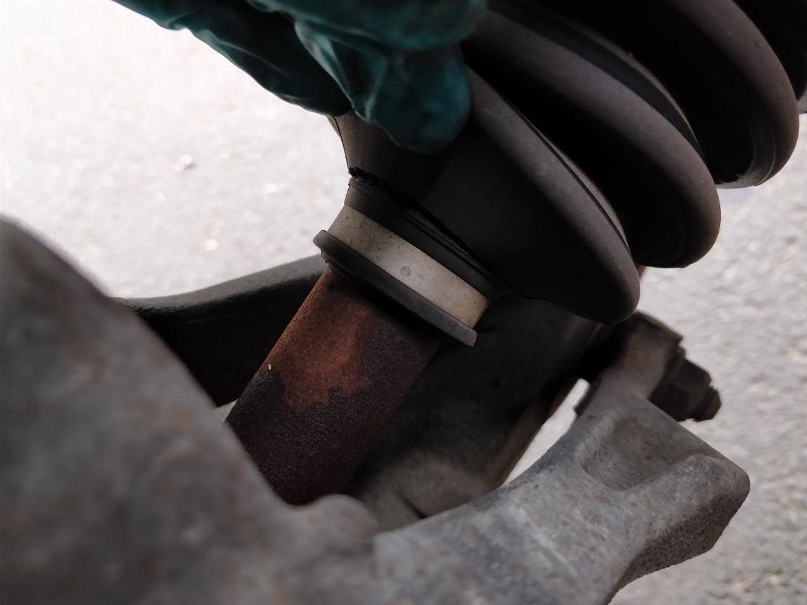

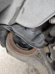

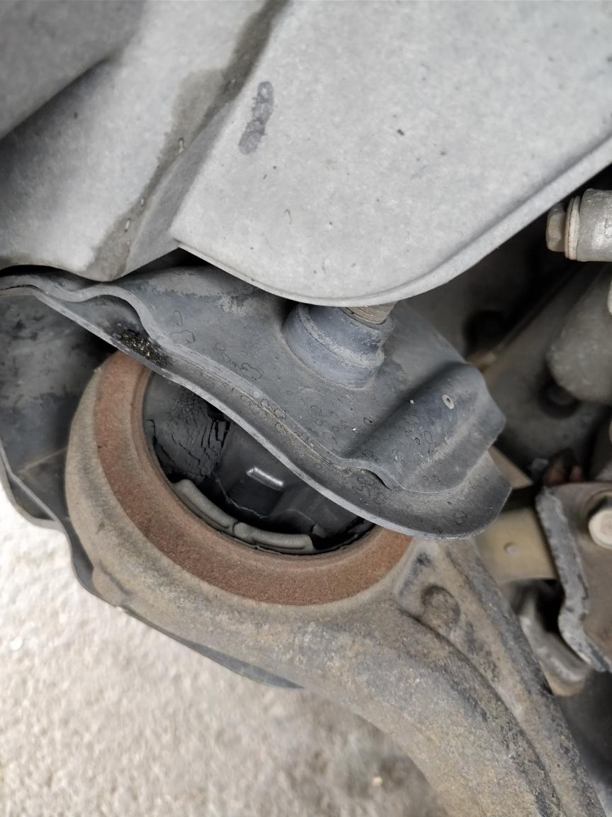

From the photos your axle boots are cracking so replace them before they break open. Usually the prices work out so it makes sense to replace the axle. What I see in the pictures won't cause any problems until the boots break open - which might be next week or next year.

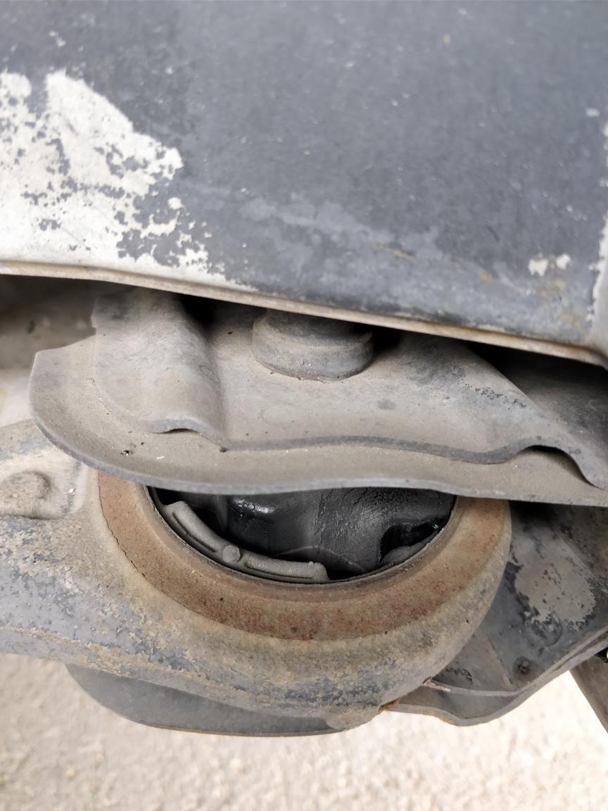

Cracking rubber in your LCA bushings, but from the photos it doesn't look torn apart to the point they're capable of creating the clunking.

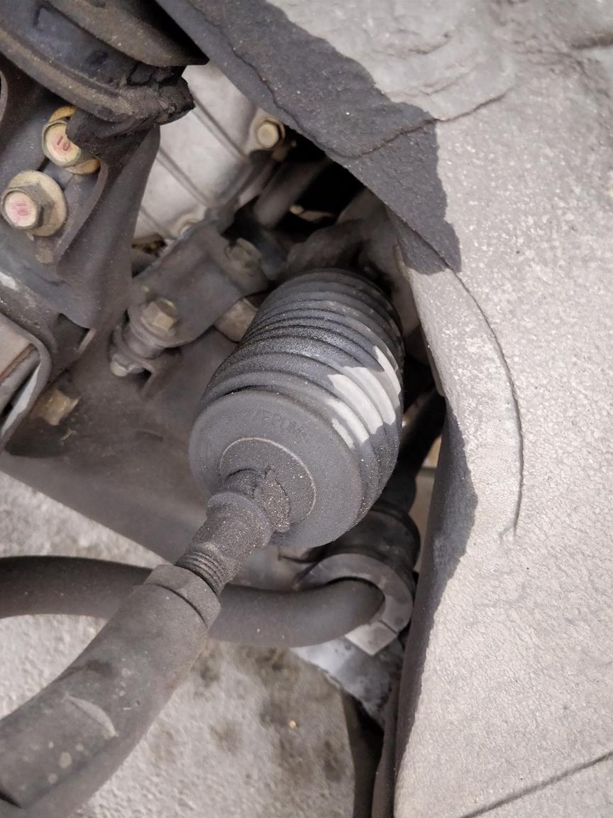

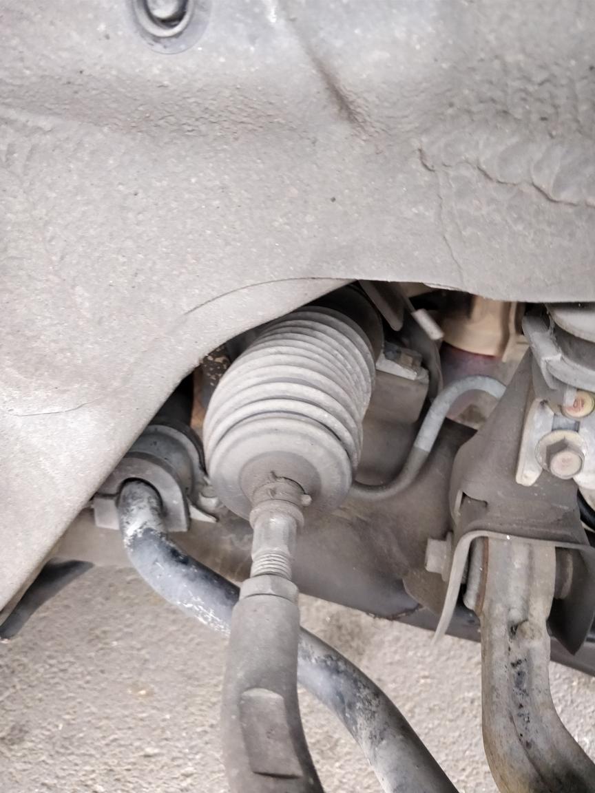

What is the part name for what's connecting to the rotor area on the right side? In the first picture it's good. In the 4th picture it's cracked and the oil is spilled out. I've been trying to find out so I can look it up but can't find anything for the life of me.

The part you are asking about is called either the power steering rack boot, or the inner tie-rod boot.

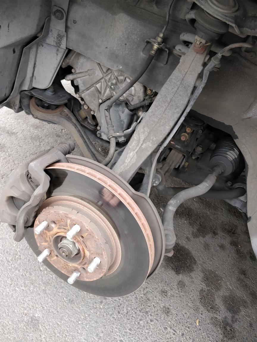

if you still have a little shaking then replace your half shafts. At this point all shaking should be gone. I didn't see anything in you pics that would suggest other parts "needing" to be replaced. But there are parts that should be replaced if you were going to keep it. If you are doing your own work then you should not have to spend more than $200 on the parts above.

For the oil, I do believe I had a power steering overfill a couple of years back. I'm guessing that's what that is.
