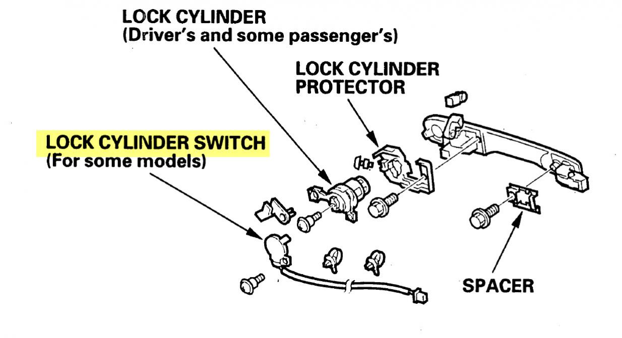

I believe I found the issue. It seems for some reason the key lock cylinder sensor stopped sending signals when the door was closed. This sensor has three contacts one pair makes contact when the door lock is opening and one pair makes contact when the door lock is closing. I was able to bend the pins using a multimeter probe. After this change the contacts seem to be working. I can now see the alarm light going on when the door is locked and turn off when the door is unlocked, also the lights seem to be turning on. The car now does not attempt to lock the doors when they're already locked or open and the door is open and closed. I can now also roll down the windows using a key in the key lock. That seems to be the issue. I am just puzzled why I couldn't turn the alarm off the fob.
Old Jul 22, 2014 | 09:01 PM
Posts: 7,101
I'm trying to make sure I understand where the issue was. Was the problem the lock cylinder switch, like in the attached picture?
Correct. It was the cylinder door switch. I bent the pins inside the pigtail connector that plugs to the male plug on the door. I don't know why it wasn't making contact. If I remember well everything was working fine when I had replaced the door lock mechanism but since I was using the fob to open the door I didn't realize I had an issue until after I locked myself out of the car when trying to dig myself out after a snow storm in February.
