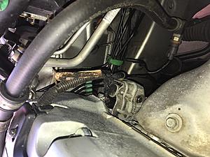

Also I was doing I little poking around and noticed that some of the wires on the back of the engine look a little burned. I don't know if this damage is new or not.
I am wondering if I should replace the entire harness that plugs into the C.O.P.s.

I would try to find any damaged wiring and repair it first. Replacing the whole wire harness is a pain.
I can't tell what is going on in your picture. What is the tan part that looks charred/oil coated in the attached picture?
