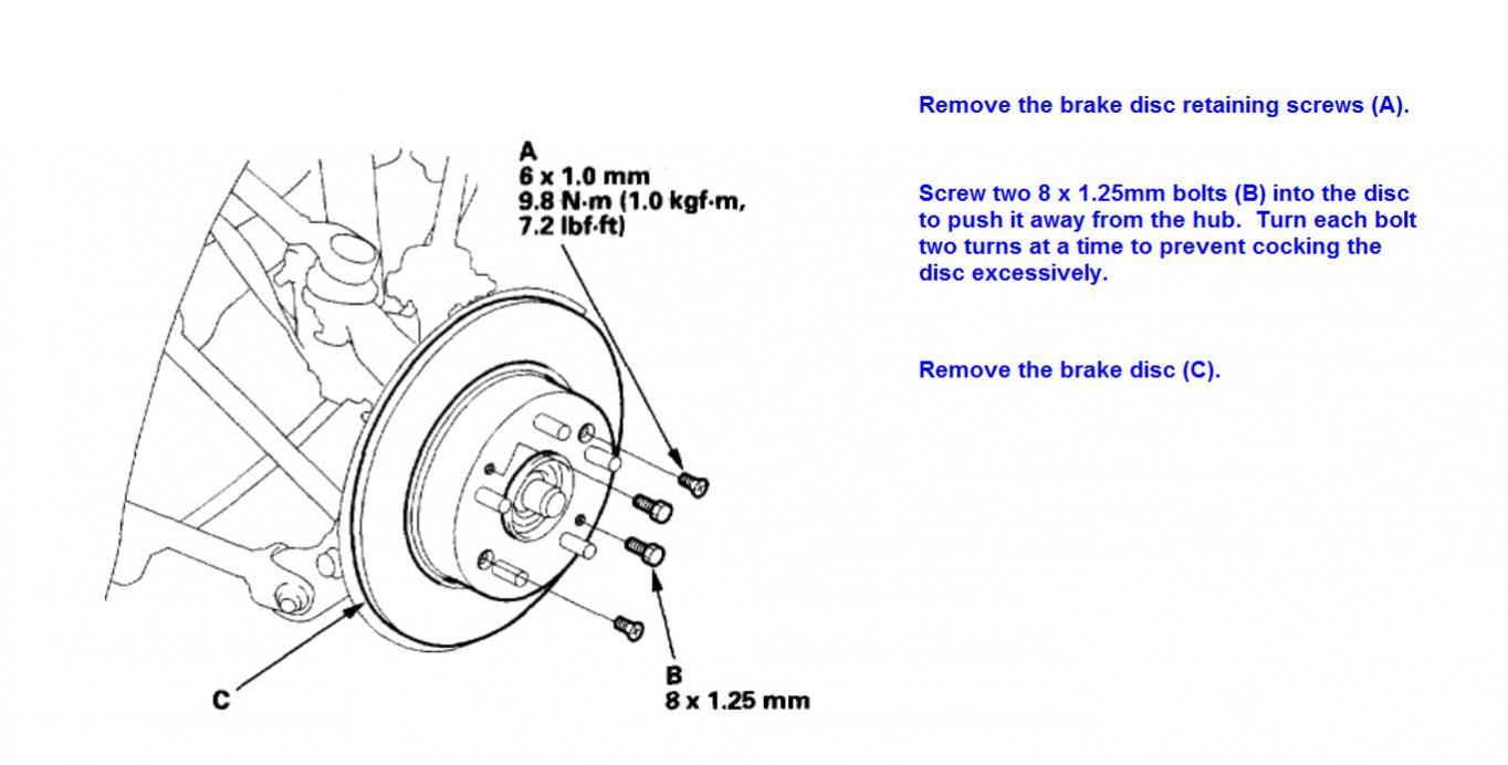

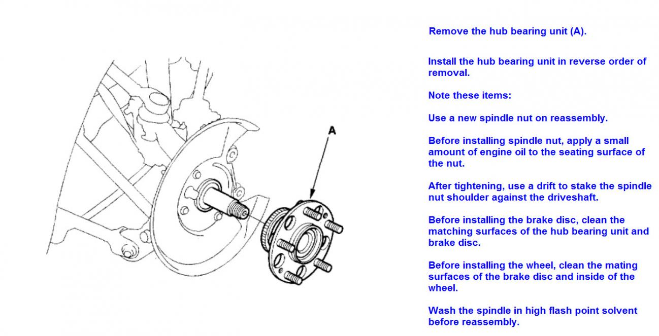

Posts: 7,101
Here's information for removal of the hub bearing unit, which includes recommended torque of the spindle nut.
Attached Thumbnails 2006 Accord EX rear wheel bearings replacement-disc-brake.jpg   2006 Accord EX rear wheel bearings replacement-spindle-nut.jpg   2006 Accord EX rear wheel bearings replacement-brake-disc-removal.jpg   2006 Accord EX rear wheel bearings replacement-hub-bearing-unit.jpg

Thank you redbull!
Wow, thanks a lot!! Makes my day.....

-- I need to go to the Honda dealer to buy a new spindle nut, I'm sure I can re-use it again, but it states 22 x 1.5mm nut, so I had someone go to Wallymart at 10:20 p.m. (closes at 11) to get a 22mm socket....it doesn't work??!! Anyways, the reason I'm going to the dealer's parts dept. is to buy a new spindle nut and bring that to Auto Zone to see what size socket will properly fit it.

You can drill the rotor retaining screw heads off, remove the rotor and turn the remaining pieces out w/ vise grips. They are not necessary to be replaced, so you could just leave the stubs in place.
