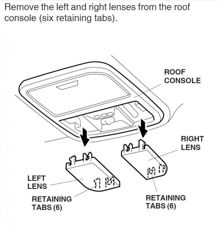

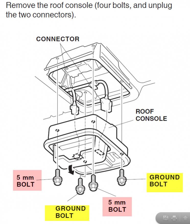

These are the general steps to remove the roof console to get to it. Use a small flat-tip screwdriver with a shop towel or something to prevent scratches when prying the plastic lenses.
Note: Two of the 4 bolts are ground bolts.
