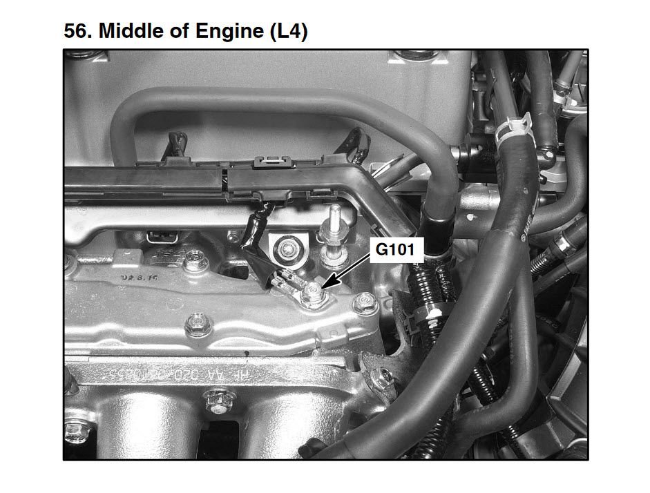

Here are some things to quickly check:
1. Under-hood Fuse No. 8 (15A). Make sure power is at the fuse even if the fuse is not blown.
2. Under-dash Fuse No. 19 (15A). This should have power when ignition switch is in ON or START position.
3. Ground G101. Check connection, wiring, etc.

I've double checked those fuses and tested every other fuse in the under hood and drivers fusebox as well. None of them have blown. I didn't use a fuse light like that video, but I used my voltmeter to measure no resistance on every one
