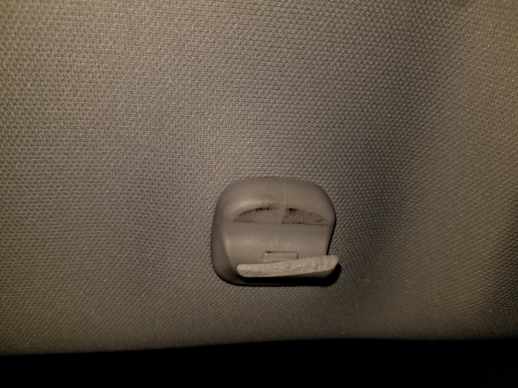

- Driver side sun visor clip tab is broken, can that alone be easily replaced? If so, can old one be just pushed out or there's a procedure for it? Also, storage compartment lid has a tear and I want to see if I can replace ONLY the lid, with the one from junkyard, again is it easily swap-able?

Sun visor clip just get one from the junk yard. They pull out.
Thanks, so just push down using a plastic pry tool or a small screw driver and it'll pop right out?

Yes just pull the broken piece down
