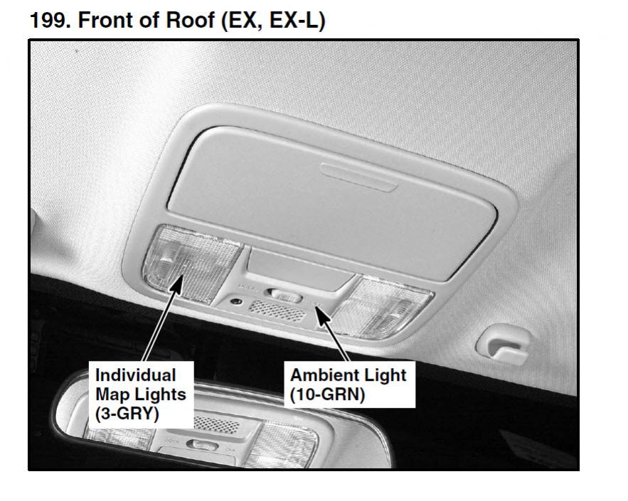

Old Jan 11, 2015 | 06:02 PM
This is an image from Honda electrical troubleshooting manual.
Attached Thumbnails 2007 Accord Overhead Dome/Door Lights-map-lights.jpg
Old Jan 11, 2015 | 06:24 PM
counsel's Avatar
Joined: Jan 2015
Posts: 5
Those are the ones. I'll inspect the terminals and see what I find.
