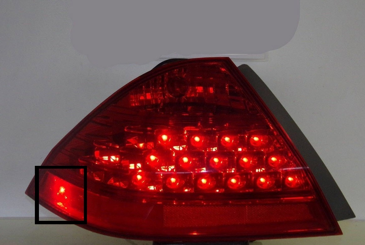

So failed the inspection because of the 'side marker light' out and whole light seems to be a single piece.
Could anyone please confirm if one LED in the side marker area can be replaced or whole light assembley should be replaced? Thank you
Old Jul 13, 2020 | 12:22 PM
LED unit can be replaced. If that is the coupe left side, Honda Part No.: 33552-SDN-A11.
For a sedan left side, Honda Part No.: 33552-SDA-A32

Thank you very much RB - real question is, that small marker light in corner is LED or a light bulb which can be replaced? It light up once headlights are turned on.
Old Jul 13, 2020 | 12:56 PM
It is an LED unit, not an incandescent bulb. Honda does sell the unit which is replaceable; but, it is not inexpensive.

Thank you, think need to hit a junkyard and get a LED unit - not sure if LED soldering can be done for the busted ones?

Looking at this, don't see the 'marker light LED'
Or that's comes as a separate unit? https://www.ebay.com/itm/2006-2007-H...temCondition=4

Can anyone please confirm where would these red and white wires will go?
Old Jul 13, 2020 | 08:09 PM
Is this a coupe or sedan?
Old Jul 13, 2020 | 08:14 PM
Seanjordan20's Avatar
Joined: Jun 2017
Posts: 1,225
Looks like the sedan tail light. From what I know the turn signal and base plate is the only thing replaceable without cracking it open

Sorry RB - yes it's a Sedan, have opened everything, LED board has a few non-working ones. Do you know what's LED number? Planning have a backup and solder a few new ones
