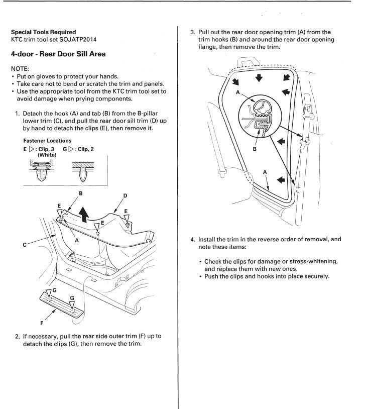

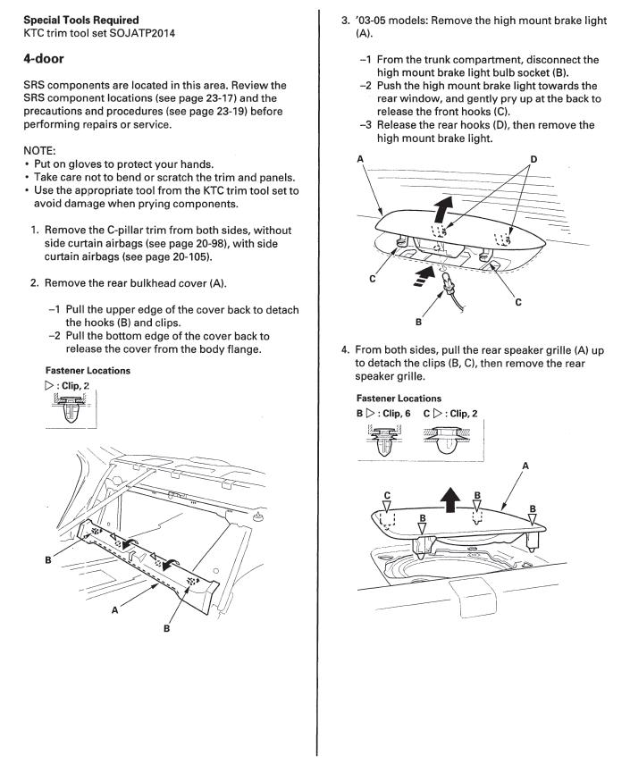

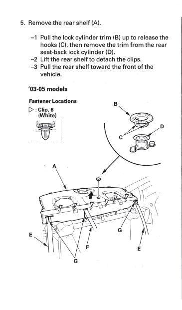

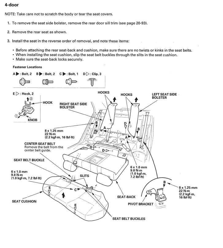

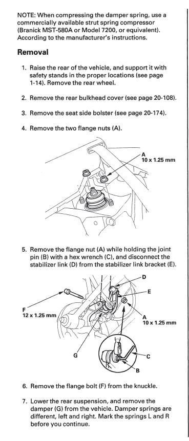

I am installing coilovers to my 06 accord i have been looking for the answer to my question and i cant find it.
"How" do you remove rear bulkhead cover and seat side bolster?
Old Jun 15, 2013 | 08:48 AM
Do you have a shop manual - this is listed on 20-108 and 20-174. Basically the rear shelf/deck out....then the side bolster.....there is talk of the sill trim as well.

Is it clips that hold it on do i just pry it off ir are there screws i need to remove?
I dont have a shop manual where can i get one?
Old Jun 17, 2013 | 04:13 PM
automaualsource dot com...$22 for a download - hope you have a good internet connection....or $27 for a shipped CD. Great customer service if you have an issue - my internet wouldn't handle the download ($21.99) for the Pilot....e-mailed them, they sent the CD for no extra charge......and I would have paid the extra $5 for the CD but they said - "we'll take care of it".
If you are going to keep the car for anytime - this >$30 investment is WELL worth it. Spec's, diagrams, how to, ect....that you will not find in a chilton/haynes type book. The only thing better would be a helms manual but now you are >$75.
Anyway there is a combo of clips, screws and "hooks". Basically the rear shlef goes, fold down the rear seat, remove the side bolster. I can try to post the pic's if you need.

Yeah man if you can put some pictures that would be awesome! I will definitely look into getting that manual though. Maybe my next paycheck lol.
Yeah I just need toto be able to get to the rear struts. If you can post some pictures or help me out with that that'd be awesome and thanks so much
Old Jun 18, 2013 | 09:08 PM
Dang, getting late for an old man....I'll let you put this together.
Attached Thumbnails 2007 Strut Replacement-rear-shelf1.jpg   2007 Strut Replacement-rear-shelf2.jpg   2007 Strut Replacement-rear-sill.jpg   2007 Strut Replacement-rear-seat-bolster.jpg   2007 Strut Replacement-rear-strut-removal.jpg

Thanks so much for posting those for me! I greatly appriciate it! Now i need to attempt this lol it looks like its gonna be a challenge lol.
I figure i will start on taking all that out so i have acsess to the rear strut when i am going to install coilovers. As my birthday is on july 2nd and thats when i hope to buy my coilovers.
Should make for a less stressful install wish me luck on removing the side bolster and such!
