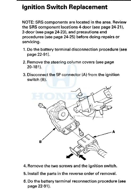

I know what you're saying. I just looked at the new one I have. Well, there is quite a bit of amps running through that, so I imagine over the years the components break
down and don't perform as well as they did when new. Now that I think about it, this may solve my issue. I going to try it tomorrow. Do I just have to remove the lower steering wheel cover to get at it? I imagine you should also disconnect the battery.
