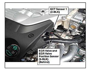

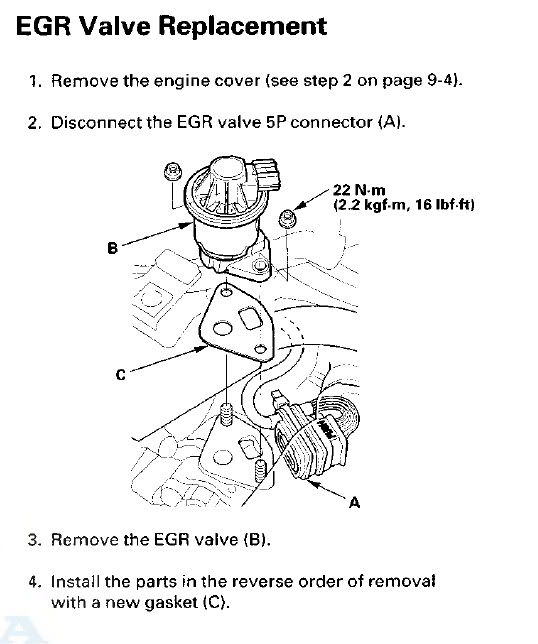

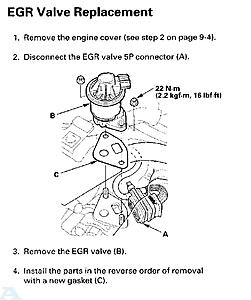

It is under the plastic engine cover.
Attached Thumbnails 2010 EX-L V6 EGR Valve-egr-valve.jpg   2010 EX-L V6 EGR Valve-replacement.jpg
