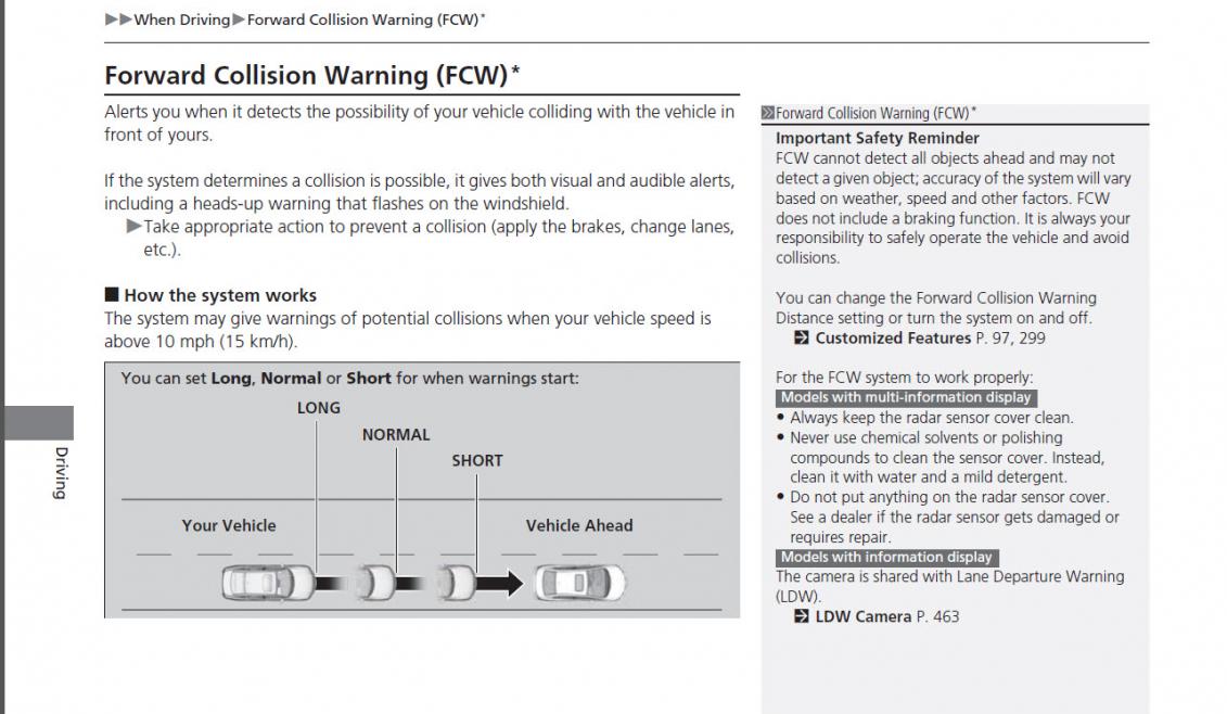

You can set Long, Normal, or Short for when the warning starts. See links and attached pics from owner's manual. It may be set to short right now.
https://www.ahm-ownerlink.com/Accord...lision_Warning
Honda Media Newsroom - Forward Collision Warning
Attached Thumbnails 2013 Accord FCW-fcw-1.jpg   2013 Accord FCW-fcw-2.jpg   2013 Accord FCW-fcw-3.jpg
