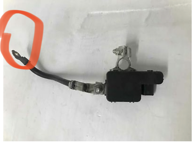

When connecting anything to ground you want to connect it to the opposite end of the negative battery post especially with ground cables having sensors. The negative cable is always connected to the inner fender. The pic below shows what end you want to connect to. I usually sand the paint off before screwing it back in.
Now I'm not saying you can't ground it to the negative post because you can. I just don't to prevent the sensor from having issues. Sparking should not happen unless you are connecting positive to ground. Honestly you can find any screw on the car to connect it to as long as you sand the paint down for a good connection.

So hopefully I can trace that Negative Battery cable to where it connects to the Fender (but I think on the Accord it is a bit buried under some other stuff) - and I suspect this 1' Cable thing I've got to work with actually won't reach - however that picture you show does look like a short pigtail type cable..so maybe... - ....but the best next bet is to find a bare piece of metal that might be available, and then I guess if not that, use the Negative of the Battery post itself .... (my fear is just connecting to the 'wrong' bare piece of metal and it damaging something or not providing the Portable Jump Start Battery what it needs to help provide the charge properly - or if using the actual Negative of the Battery I didn't want to damage this car electronics by not doing what is explicitly mentioned in their instructions... (as well as any risk of causing some sort of 'boom' ...which seems remote - but still)
Thanks for the pictures of what I should be looking for! I have just never had any reason to do this - nor have I used these little portable jump start battery packs. (I see videos of people just connecting other models of these little suckers directly to the negative of the battery itself, but the models they use don't actually say to connect it to a Ground like mine does! haha....
