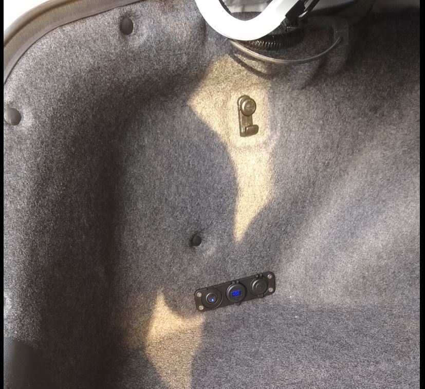

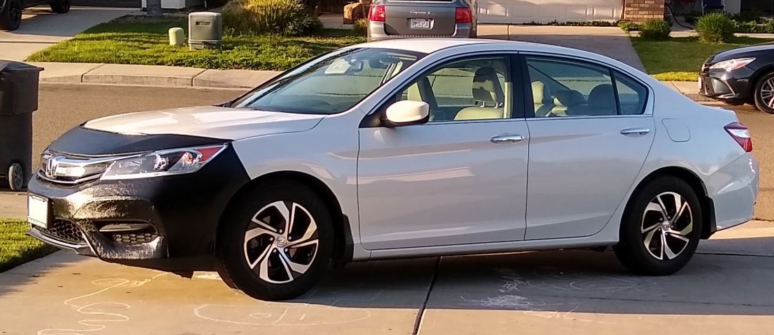

That one lamp has never lasted more then 6 months since we got the car in 2021. It's just that one location. It had less then 20k on it when we got it and it is still like new. We had the windows done with 3M Ceramic IR (not shown) and put an OEM bra (sorry, nose guard) on it right away. I also added a power outlet panel in the trunk. Other then that and switching to goodyear tires, it's still stock.
