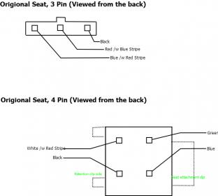

I've added diagrams showing the connectors for the existing manual seat, the wire harness in the car, and the new 4-way seat.

Your diagram is not matching your description.
The new seat has a 3-pin and a 7-pin connector, but your diagram has a 4 and 7 pin connector.

sorry the new seat has a 4 pin and a 7 pin connector as in the diagram.

I know I keep asking questions, but your wiring description does not match the wire colors in the shop manual.
Did the original seat have a motor that only adjusted the height?

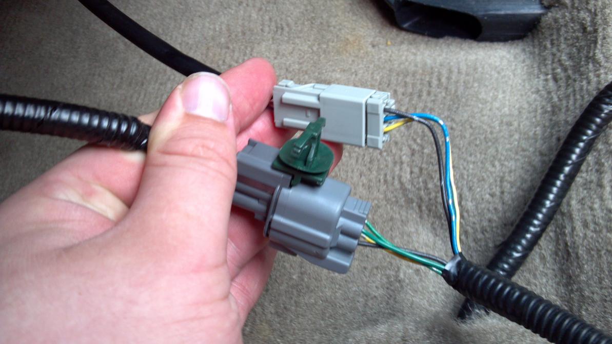

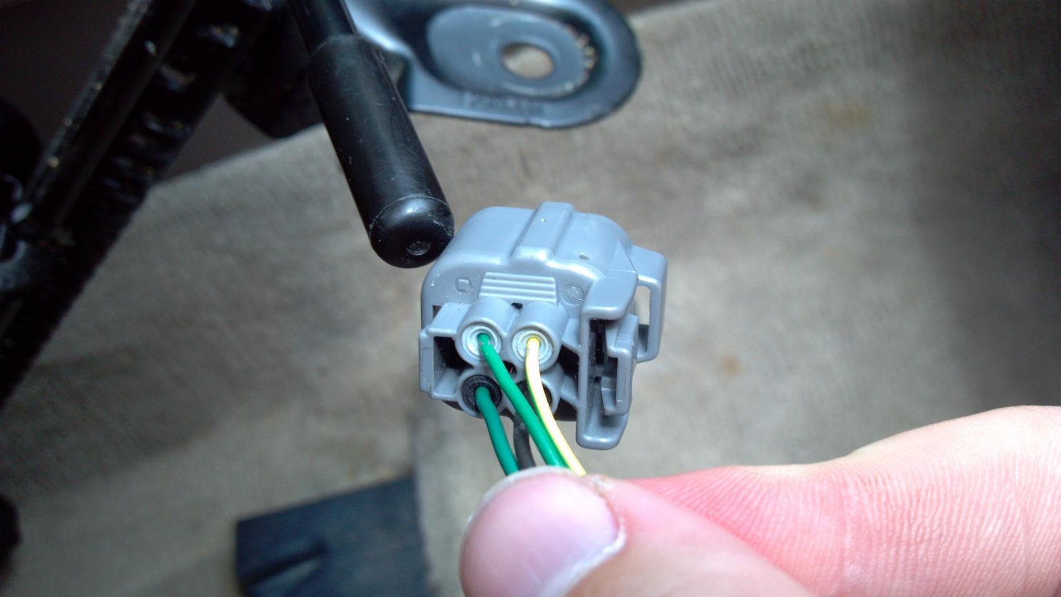

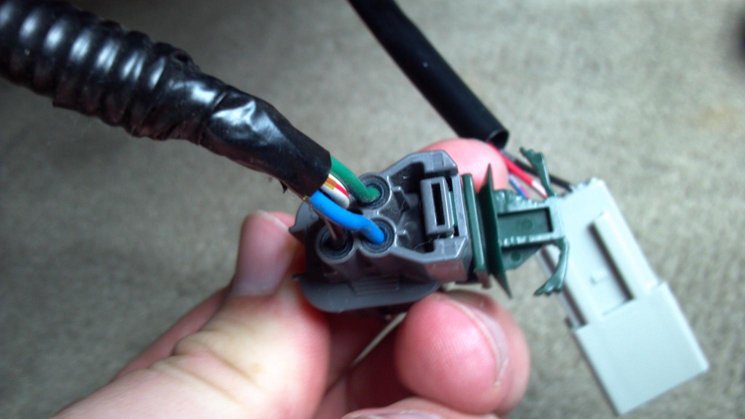

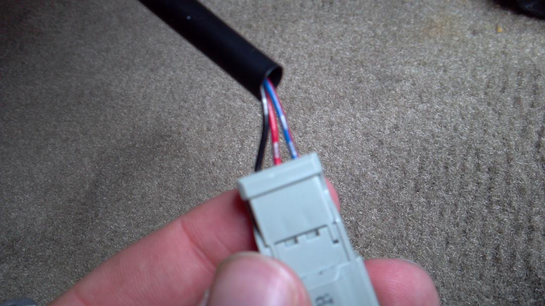

I've attached some photo's to show you the wiring. The original seat only
has a lever to manually move it forward and back. Not sure why there is a 4-pin and a 3-pin connector.
