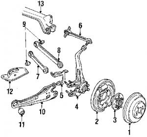

Well just refilled the PS container after work so ill check it on my break tomorrow and see if there is a noticeable difference in the PS fluid, i checked over the hoses and there seemed to be a little bit of liquid around one of the seals but not for sure, hopefully this will tell me.
As for fixing the rear left lower control arm i'm really not experienced with doing more advanced maintence. Only decided within the last year to start learning how to restore cars and thought id start with my first one.
The control arm piece i was "told" to replace was part number 8, but seeing as how i was pretty much fooled id like to double check before undertaking this myself.

Hang on. The first time it was the upper now you're saying the lower...I assumed by your first question about the arm it was the front upper control arm. The pic is on the rear of the car?

Yes it is the lower arm, i confirmed this with local car restoration buddy of mine. It is in fact the rear control arm and not the front, i appologize for the confusion.

There is a short one just forward of the tire, has the adjustment bolt for suspension adjustments. Then there is the longer one aft of the rear tire. Which one-short/forward or long/aft. If it is the short one-then yes the one in the link is what you need.

No its not the short one, most definately the longer one...about how much time should i set aside to undertake this fix because it feels like it might be a 48hr fix with my "skills"
