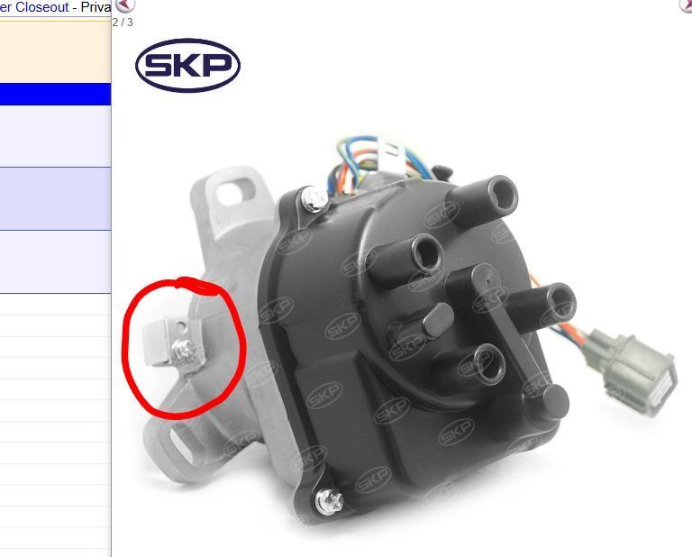

One more question fellers. This small metal clip on the bottom side of the distributor, is there anything supposed to be there? The other clip has the clip that holds the wiring connections but this one is on the bottom side when the distributor is mounted. Almost looks like a ground clip or something. Just making sure my vehicle isn't missing something that is supposed to be there also. Thanks.
