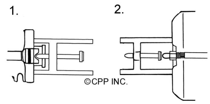

Old Sep 5, 2019 | 02:43 PM
Here's a brake tool that you'd use on some Chevys. I only show it here because it's more obvious how it works.
Honda's tool looks like this when it's put up against the master cylinder.
And... I'm not sure if that part number is the same for any & all Hondas? Or if there's different ones with different size or shape depending on which Honda.
