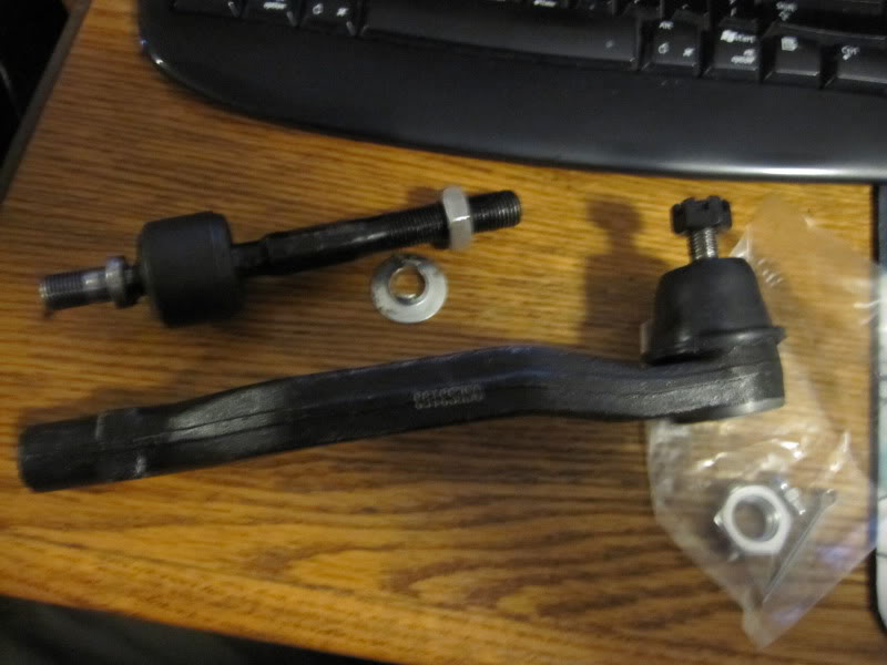

Well I believe the vacuum line being disconnected on the drivers side boot has to do with it and allows water/dirt up in there is a possibility.
Good news is I have some new parts laying around from my 90 honda accord (sold it) and found brand new inner and out tie rods for both sides.
So is there any specific way of going about replacing these that I need to know? Im pretty handy with the wrench as I've pull my wrx engine and replaced the clutch/flywheel not too long ago.
But, Im going to put these on and replace the old ones and if I am still getting the "click click" sound then its the axles and they will be replaced if need be.

I would replace the rack boots and you will need to keep the tie rod assembly overall length the same or you will need a wheel alignment. You should be able to look at the parts to understand the order of replacement. As you are going with new tie rod ends you can use a pickle fork to get the outers out of the steering knuckle.
