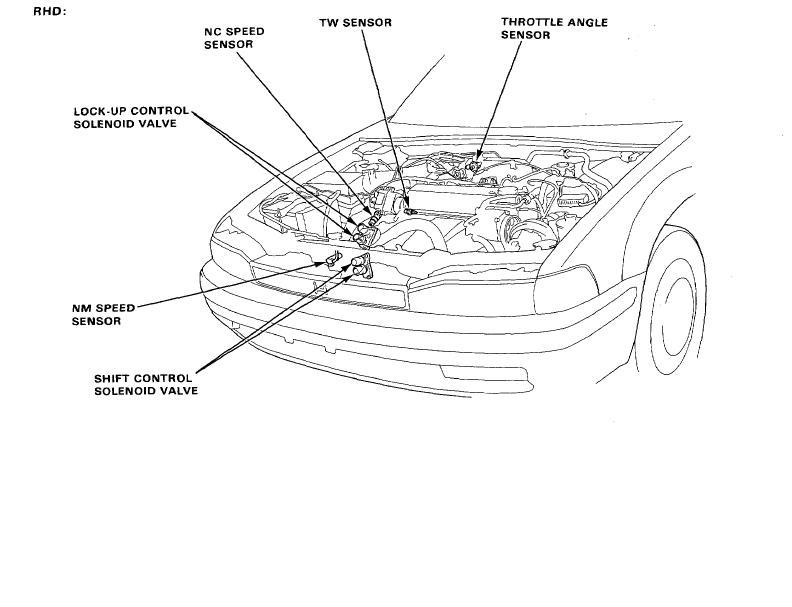

Any stored codes?
Have you checked the solenoids?
Then I'd suggest a drain and fill...or two or three with Honda trans fluid.

where are the solenoids?

Look in the Common DIY Threads (second from the top) In there you can find out how to check for codes. There is also a link where to get a manual for the car.
See if these get you going.
Honda Electronic Transmission Problem- Troubleshoot, Inspection, Repair, Replace.
