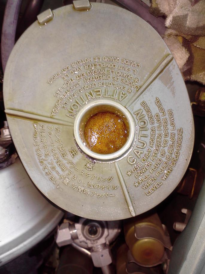

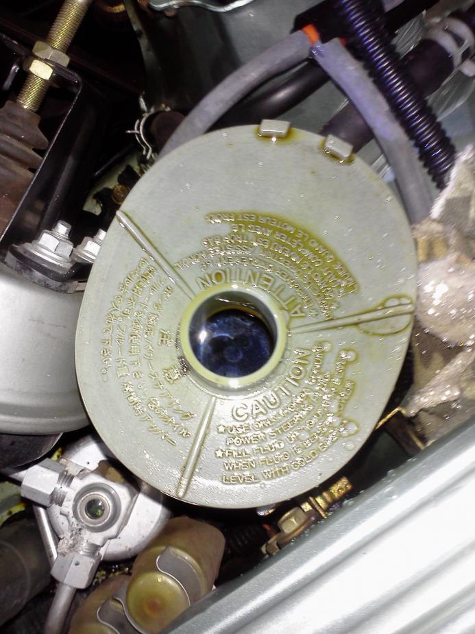

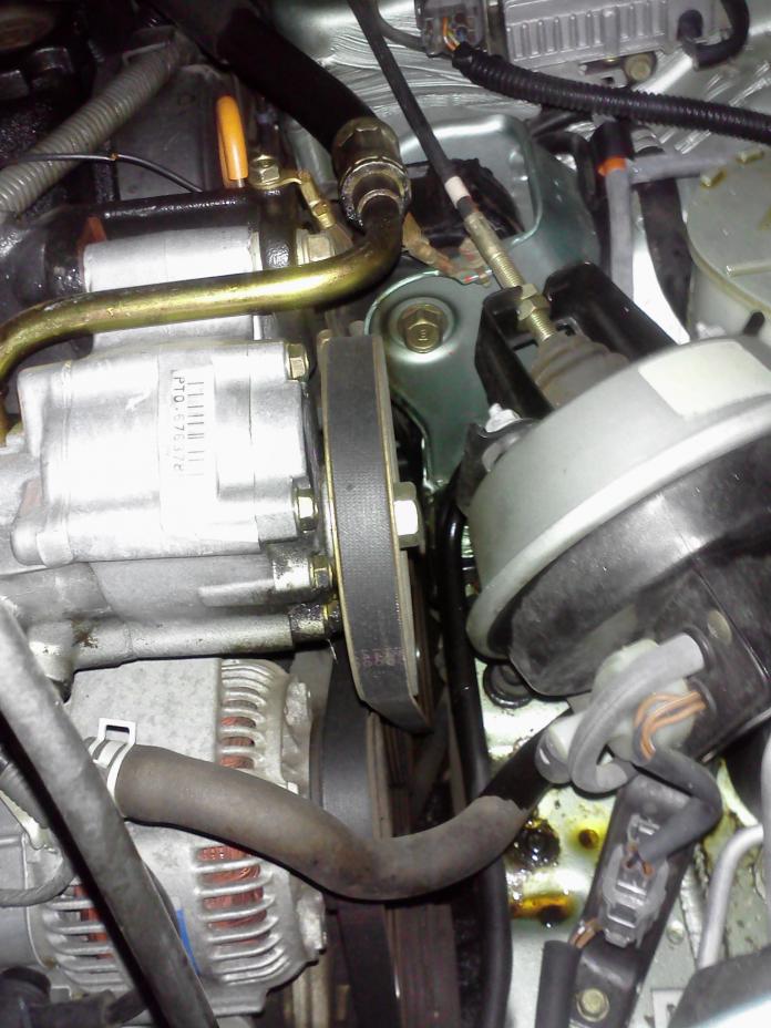

Howdy Folks,
230K It all started after changing the left front axle! I don't know if its related or no
I start noticing high amount of oil leak under the car, at first i thought i must parked when someone else car leaked! but the shock was when i parked it in my drive way. it was my car that is leaking
I start hearing whinning when i steer the car and i noticed that the steering reservoir on time will be at or below the Normal level! i top 'd once. and some time it a lot higher than the normal level.
two days ago i open the hood to check on it and the reservoir cap was all the way out and hidden underneth the resevior it self, which mean there is enough pressure to popthe reservoir cap ??!!!!
what could cause it to flood like this, i hope you can see it in the pics i will attach.
Now i don't know much about cars, but i am handy and can figure it out, and hopeing with your help folks i will be able to fix my honey. i am welling to learn so i can take car of my baby.
Thank you in advance
Attached Thumbnails 92 Accord LX Steering Reservoir flood- Help-img060.jpg   92 Accord LX Steering Reservoir flood- Help-img061.jpg   92 Accord LX Steering Reservoir flood- Help-img062.jpg

I believe that with that cap off, it would sling the fluid out while you were running it..

I hope you are using Honda/Acura PS fluid.
One could be related to the other.
First, do you have a leak in the PS system. If so air can get into the system which would cause bubbles, sometimes foaming in the res.....Start the car, check the fluid in the res for bubbles, starting to foam. Might have to turn the wheels side to side as well.......

When the engine is running, you should see fluid swirling around in the reservoir but there shouldn't be any air bubbles forming. If there is and your P.S. pump is making a buzzing noise, which gets louder as you turn the wheel then air is entering through the inlet of the pump. Possible remedies include replacing the O-ring at the inlet tube and/or replacing the rubber hose between the reservoir and the P.S. pump; both are fairly inexpensive solutions.
Old Dec 31, 2011 | 02:06 PM
Roader's Avatar
Joined: Jul 2011
Posts: 1,008
From: Denver
Another common failure is the pump shaft seal, especially after the PS pump belt is adjusted tighter, causing the pump to cavitate and the entrained air to push fluid out of the reservoir. Junk yard pumps are cheap and it's a ten minute job to replace it.

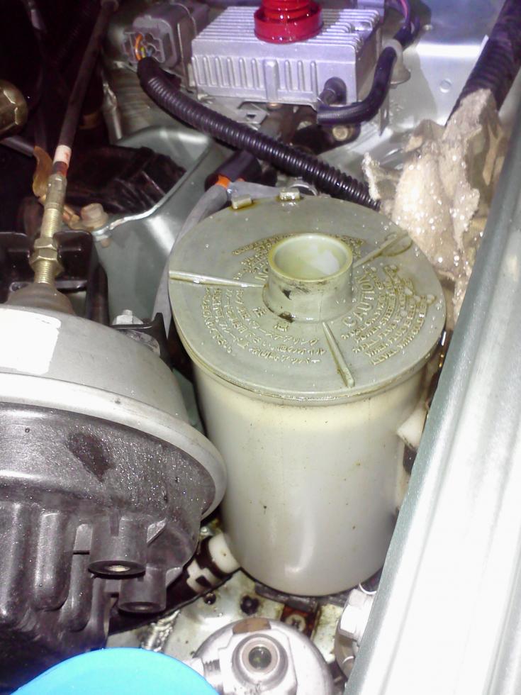

I always thought it is coming out from a crack in the hose for being so old. but yesterday i did the check that someone here ref to, what i did is i took the reservoir cap off and started the car and turned the wheel all the way to the right... all the way to the left and when i reached the max point in the left position , i was looking at the ps reservior and i saw the fluid foaming and actually and sprung out. so i cleaned it and tried to duplicat it again but nothing happen <check attachment>

Like others stated, you have a leak in a hose or something and air is getting into the system. Try drying things up and looking for the area of the leak.
