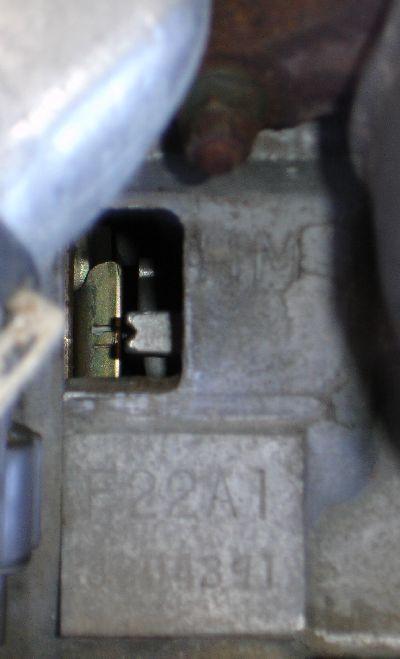

On the 92 accord there is rubber plug for you to look at the gears on the drive plate and a pointer.
Turn the engine by hand using a 19mm socket on the crank pulley until the mark on the drive plate lines up with the pointer. See pic.
Remove the distributor cap and see if the rotor is pointing to #1.

Thanks, still no dice though. Set it to tdc, dizzy was spot on. Checked my compression and it's between 130 and 150 all across. So now I have confirmed compression, fuel sprays from the banjo, and the plugs spark...
