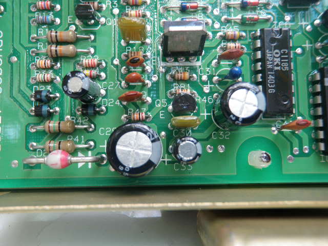

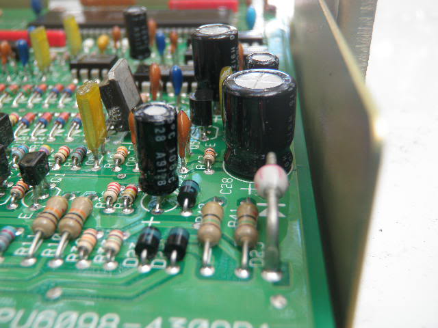

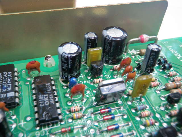

so i finally opened up my TCU and found no damage. i'm at a loss here. if it shows no damage is it still bad? if it's not what else would reset for almost a week the first time and over 2 weeks the second time when i pull the back up fuse to reset codes?

Old Sep 23, 2011 | 04:14 PM
  #20
Posts: 16,337
You can try testing the resistance across those resistors 41, 42, and 43 with a volt meter to see if they are in spec.
The caps may not be in bad enough shape to start leaking. The top of a bad cap will be more rounded before it starts leaking. I can't see C5 in your picture.
I would also inspect the solder joints for those capacitors and resistors to see if there is a crack in the solder joint like in a main relay. You may want to take a close look at all of the solder joints with a magnifying glass to see if one of the solder joints has a problem.
You can price out new capacitors to see if it is worth a shot to fix.
