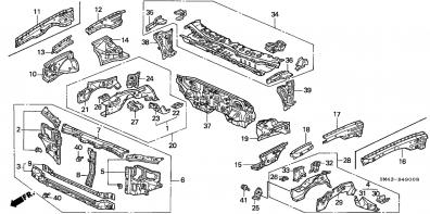

Thanks for the suggestions but so far nothing is coming up with the core support with all the parts connected to it. I saw somewhere else that the core support is tack welded into place on Civics. I assume that is true for Accords?

What is the "core support"?? Do you mean the structural stuff around the radiator? Or maybe the suspension sub-frame?
Those pictures come from Honda's electronic parts catalog & some of the "category" names are a bit obscure. It's a tedious job to look through ALL the categories to find where they put one piece or another.

The core support is the pressed metal structure between the two fenders across the front. Honda may call it a radiator bracket.

Category = Bulkhead
part #7
(I think #8 is that vertical strut in front of the radiator?)
