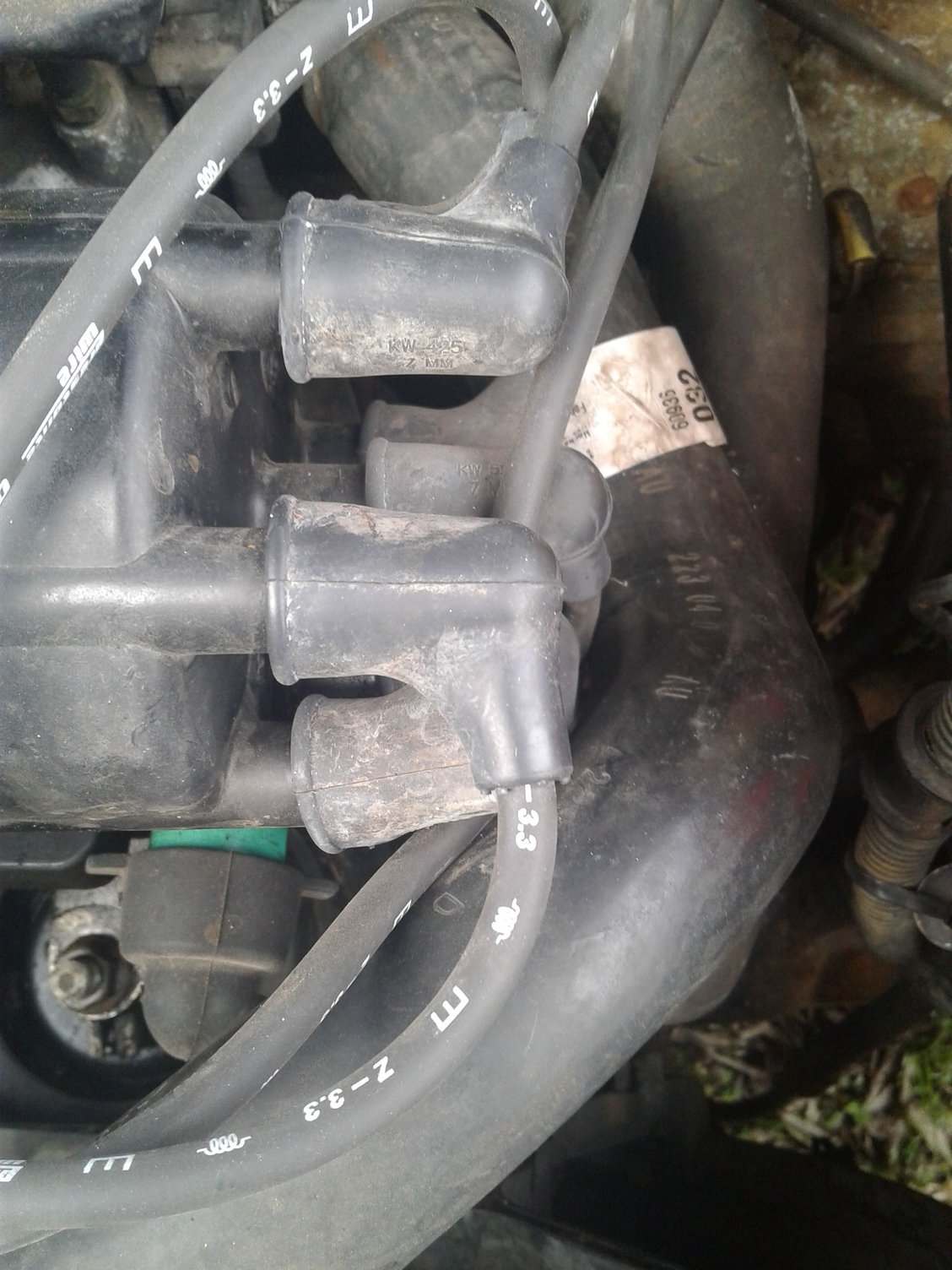

Let's see some pics of some upper hoses in cars of those years. My upper hose is seems wrong. It's so squished against distributor and almost at an angle where it meets radiator fitting. Keeps leaking. New hose. Will get pic and hose number when sun comes up.

Brand: CONTINENTAL ELITE
Part Number: 60936
looks like the hose that is on it... which is the wrong hose and does not fit this vehicle..
should be 62112 of that brand.. if I'm correct

Got correct hose in, huge difference. Way more room
