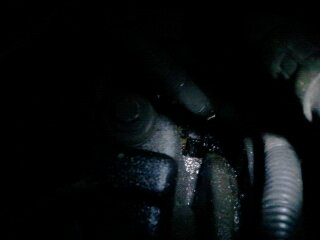

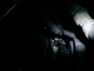

My 94 started loosing coolant when the engine heats up and pressure builds in the system. The leak is coming from somewhere below the timing belt cover. I stopped at Autozone and had them take a look and the worker said he did not think it was a head gasket but instead could be the timing belt cover gasket. I mentioned that only in the mornings upon start up, I car stumbles and as soon as I start to accelerate, I can hear a sputtering sound that reminds me of an bad plugs or wires but it goes away after accelerating for several seconds. The worker said it sounded like I was describing a lifter problem, but I am not sure if lifters would have more of a hard ticking sound. I also asked if he though the coolant leaking could be related to the lifters and he said yes. I took pics of the spot where the coolant starts flowing from. If you'll notice the big plastic timing belt cover, you'll also see a grimy, gunky level right beneath it. The leak is spouting out from a spot somewhere right above that gunked up platform. Another thing I need to mention is that when this happened today, I had to obviously stop the car because it was overheating, but I also check the oil and it was almost empty. I am pretty sure it was already low, but only a quart low because I had check it the previous day. The car runs like it always does(which is rough) once I let it cool , refill with water, and start driving again. There is no smoke from the tail pipe and I don't think I am seeing any discoloration(milky) in the oil. Please take a look at the pictures I provided as I tried to show the spot and also the water shooting out when it gets hot. What does this sound like?

The water pump is under the lower timing belt cover and likely is leaking by the shaft.
Access to water pump requires same steps as timing belt replacement and timing/balance shaft belts must be removed. If you haven't changed timing belt/balance belt recently, you may as well replace them with the water pump.

The two symptoms together indicate a leaking head gasket. If you can verify that the external coolant leak is coming from between the head and block then it's certain.

More than likely it's the waterpump and at least needs some partial teardown and inspection...the timing belts are probably coolant soaked and will need replacement as well...and about timing covers holding in engine coolant, older Pontiacs use a combination cover.
